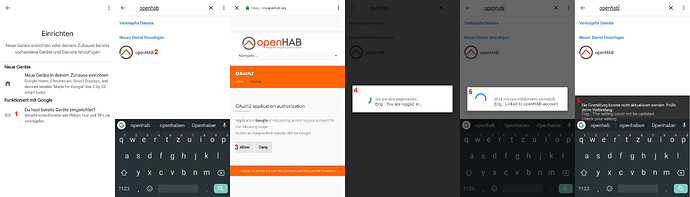

I want to connect my Openhab with Google Home. I created a myopenhab account and I can control my openhab from everywhere. When I try to link my Openhab with Google home, over the Home app, it says after “Connected to openHAB-account” → “The setting could not be updated. Check your connection.”.
Under openHAB Cloud - Log in it says, that Google is linked, but in the Home app not.

This how i try to link:
Because I can post only one picture per post here is my Cloud connector and myopenhab.org My Application:
