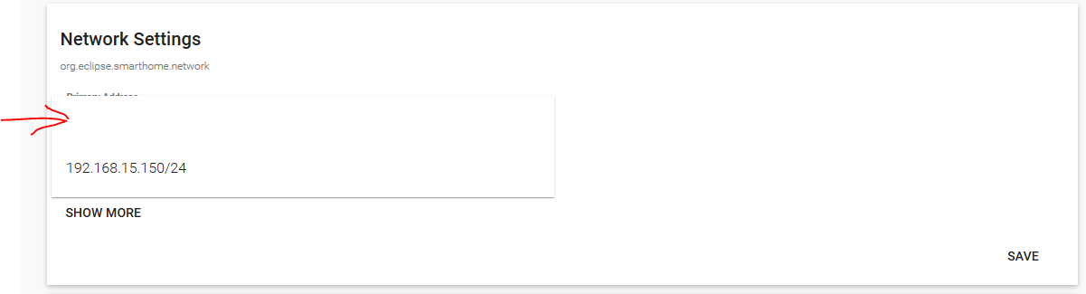

change ip in Paper UI - Configuration - System - Networks settings
by error i added the server ip and not the ip range, how to change it?
on the gui i can’t modifie this feld.
where are this information stored?
have a nice day

I’m pretty sure this is a drop down setting so don’t worry, it’s just a wrong description.
Hello @Udo_Hartmann
thanks for you patience for all my beginnersquestion
and the Information should be a IP Range not just the IP Address i did it wrong when adding.
and i found it the information is stored there
vi /var/lib/openhab2/config/org/eclipse/smarthome/network.config
but in the gui nothing change if i do edit the file in cli

NEVER(!) change internal files from openHAB without exact knowledge.
Never change one of these files without stoppping openHAB.
Don’t input values directly in these files if you don’t understand the value itself.
In fact, yes, it should be a subnet, but, as openHAB itself provides this value (you could not set this other than selecting the entry from list), please only set this entry to nothing
The complete value is (as stated in the parameter name “Primary address”) The primary address plus subnet mask /24, so it’s easy to calculate the correct subnet (whicih should be 10.147.42.0 indeed).
