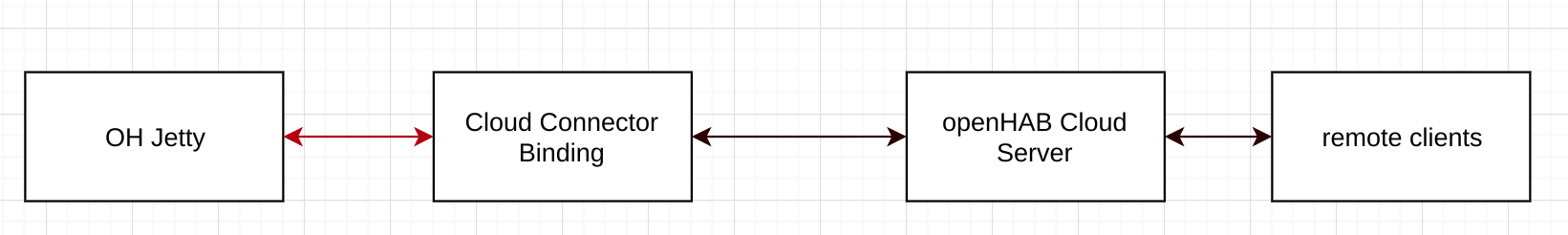

Rich,
picture worth thousand words! Eventually I got how the full chain works.
This however doesn’t explain to me how it happens that on each request from ‘remote clients’ I’m getting Jetty connection refused in other words there must be some messages flying from OH Cloud Server (myopenhab.org in this case) to the binding or even to Jetty to trigger Jetty to connect (and therefore complain it is refused). Do you know how it works?
Until now I thought it is connector trying to connect to my jetty on each ‘remote client’ requests and that my jetty is refusing the connection therefore I expected ports to get opened. From what you are saying this is not the case, right?

myopenhab.org and the Cloud Connector binding basically just proxy your OH’s Jetty and REST API. But I believe that the connections are always initiated by the Cloud Connector. Your remote device connects to myopenhab.org but myopenhab.org is already connected to your Cloud Connector binding so there is no need for a new connection. I could be wrong about that.
If I am wrong, then assuming the connection is being caused by trying to connect a remote client then the connection that is being refused would be between the Cloud Connector binding and your OH’s Jetty.

You wouldn’t find anything about port 8080 there. This is the settings for the encrypted connection, port 8443. 8080 is unencrypted so doesn’t need those settings.
Unless you messed around with the settings the problem is unlikely to be a settings problem. Thousands of users are running through myopenhab.org without any problem whatsoever. If it were installed wrong none of their systems would work either.
Also, this isn’t likely to be a setting that directly refers to port 8080, though it could be. It will be a network interface setting that defines what IP addresses it will accept connections from. Again, this is unlikely to be caused by the settings files because everyone else’s would be broken too.
<SystemProperty name="jetty.host" default="0.0.0.0" />
The 0.0.0.0 on this SystemProperty for port 8443 indicates that it will accept connections from any IP address.
Makes sense what you are saying. There are many however who have similar problem like mine and these threads (even in this forum) stay unanswered.
I accept your way of thinking though and therefore I need a step back and understanding where to find logs to understand what is happening (which part needs to be put in debug). As problem is 100% replicable and ‘on-demand’ I could collect them immediately.
At a minium the Cloud Connector Binding. Jetty may need to be put in trace log level too, though I wouldn’t expect much useful from that.
Like yours or exactly yours. All of the similar threads I recall reading had no connectivity between OH and myopenhab.org, or had problems exposing Items to IFTTT through myopenhab.org. This is the first thread I’ve seen that indicates remote connections being refused.
And if the problem were in the configs, and you didn’t change the configs, then we would all be seeing this problem, not just a few.
