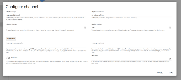

Sound good. Next step should be to configure a slider to use with color temperature. Just di it like the dimmer or RGB Slider and the post a screen shot. Typically you will have a more button on the screen just use it to see al the options.
These are the settings for the color temperature slider.
I think my thinking error is the absolute minimum and absolute maximum, this is about setting a limit between 0 and 100. But I have no idea how else to configure it.
Ok fine i tought that the where a similar option to the incoming Transformation, but for output it is only formatting.

I believe you are using the channel’s “absolute Minimum” and “absolute Maximum” settings in the correct way here, to convert 0-100 into 153-500.
I am not so sure these work properly in all OH versions though.
You can monitor what MQTT messages are sent by using some third party tool, like mqtt.fx
I tested it again and logged it with MQTT.fx. It sends the absolute minimum and absolute maximum to 153 and 500 only the command with values from 0-100, even after a restart of my Raspberry.
