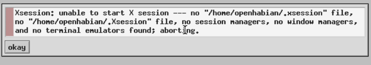

I’m trying to login to GUI but when I tried openhabian:openhabian :
tvnviewer_S6HCAGevST
About “start the X server”, I tried the command “startx” but nothing happen :
openhabian@openhabian:~ $ startx
-bash: startx: command not found
