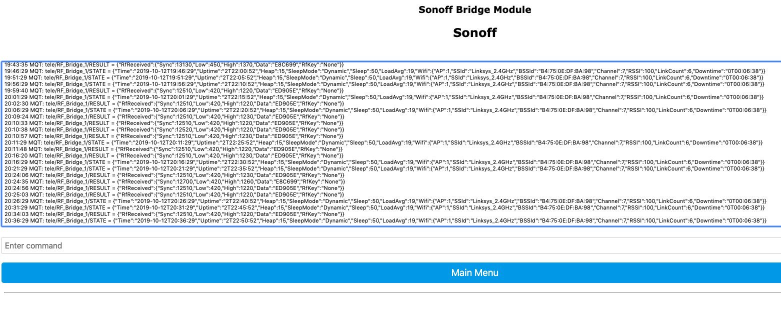

@opus hi there and thanks for the usual help.
It was just the wrong screen shot…actually this is my bridge in tasmota console:
As you can see, the message is composed of multiple section but I just wanna start by adding the right item format to detect a change.
