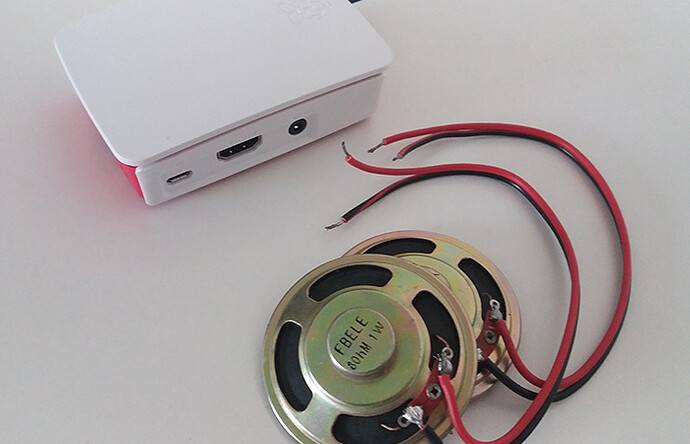

Dear Community,
In raspberry pi 3 B+, can I connect its “4-pole stereo output and composite video port” into two speakers (8ohm 1w) safely using wires and connectors only, I mean without amplifier or resistor… ?
Actually I saw the following blog, they used MAX98306, so do I need it ? http://blog.whatgeek.com.pt/2015/04/give-your-raspberry-pi-the-power-of-speech-with-adafruits-max98306/
Yes, if you wire them correctly:
But you won’t hear much because the power provided by the jack is much too low for passive speakers.
Buy the amplifier or an usb sound card, or even better a PiHAT to get sound out of it.
https://www.raspberrypi.org/blog/introducing-raspberry-pi-hats/
This is only ONE example for an audio hat, there are a lot more on the market.

Is it ok to use usb ports of rasbpberry pi as usb power supply for such these devices shown in the photo (Remotec ZXT-120EU & Speakers) ?
