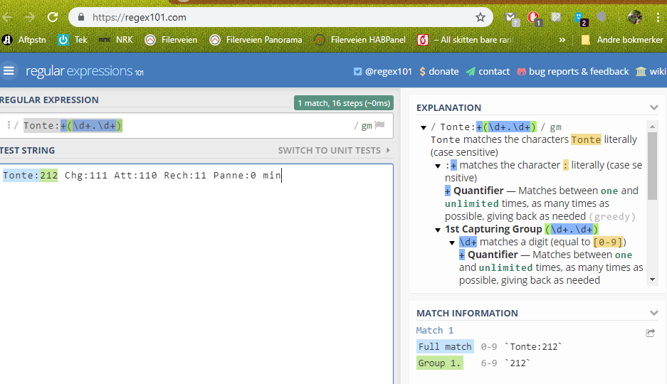

Or you can use RegEX with the folwing example:
In Openhab this becomes something like:
s/Tonte:+(\d+\.\d+)
also see this post:
Very good point @Jostein89
I though of that, but regex is obscure enough without having to introduce a transformation on to of that.
I wanted to show the programmatic way of doing it.
