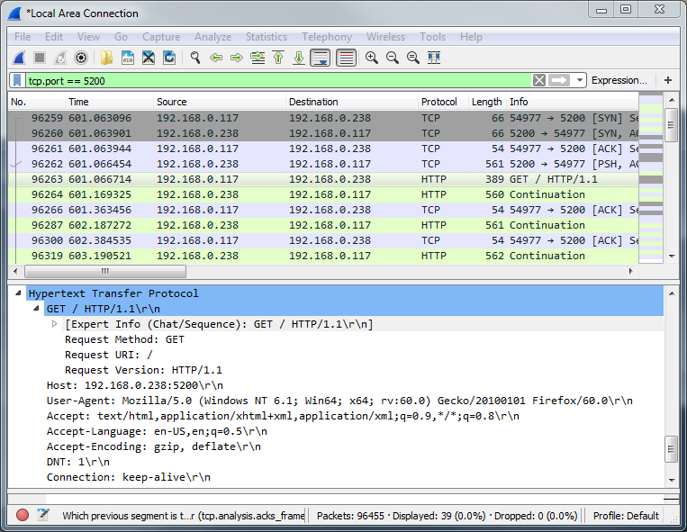

I did some sniffinq with wireshark and that’s what I got

sadly this also fails with log entries:
[ERROR] [.smarthome.model.script.actions.HTTP] - Fatal transport error: java.util.concurrent.ExecutionException: org.eclipse.jetty.client.HttpResponseException: HTTP protocol violation: bad response on HttpConnectionOverHTTP@202af766::SocketChannelEndPoint@6abd00ca{/192.168.0.238:5200<->/192.168.0.238:54337,OPEN,fill=-,flush=-,to=0/0}{io=0/0,kio=0,kro=1}->HttpConnectionOverHTTP@202af766(l:/192.168.0.238:54337 <-> r:/192.168.0.238:5200,closed=false)=>HttpChannelOverHTTP@7cc6883c(exchange=HttpExchange@7fcba7bd req=TERMINATED/null@null res=PENDING/null@null)[send=HttpSenderOverHTTP@55067e(req=QUEUED,snd=COMPLETED,failure=null)[HttpGenerator@2ecfdee{s=START}],recv=HttpReceiverOverHTTP@4aa302e7(rsp=IDLE,failure=null)[HttpParser{s=CLOSE,0 of -1}]]
That seems important, like missing a security step or something.
