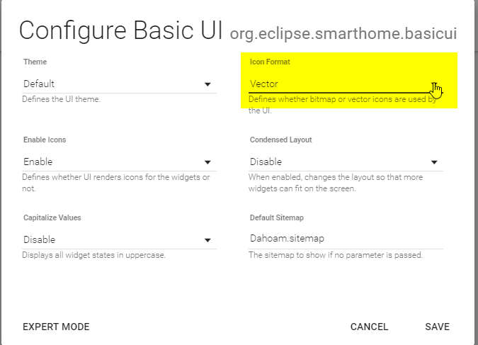

Is there a way to use these by replacing the .png icons or some other configuration is also required somewhere that should not point the image to .png and instead should point to .svg?
Within PaperUI, go to
Configuration → Services -->UI → BasicUI.
You can change the icon format there:
Thanks, this was helpful.
