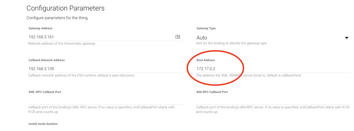

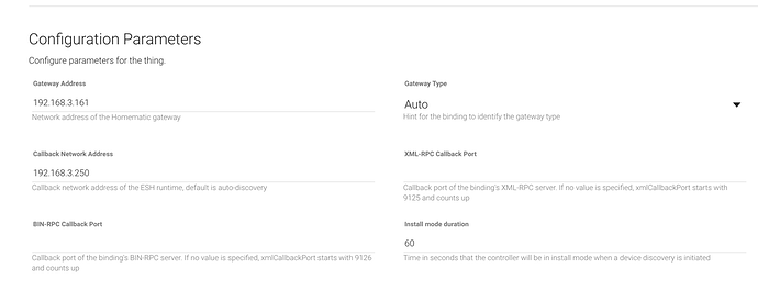

openhab is attached to two networks:
monitor 10.0.0.0/24
proxy 10.0.2.0/24
the proxy network is the one the connection to the outer world should happen outbout and inbound through reverse proxy.
is there any possibility to set this network affinity outside of paper ui?
Or are ther any other ideas why this does not work
Editing /var/lib/openhab2/config/org/eclipse/smarthome/network.config and setting subnet and broadcast address eliminated the WARNINGS.
https://community.openhab.org/t/parameter-setting-org-eclipse-smarthome-network/36545
Still having problem s in PaperUI:
Add-ON menue not visible and all Configuration Sub Menue not accessable getting an 503:service not available error message
Maybe you choose “minimal” or “simple” at first startup?
Please stop openHAB2, go to
/etc/openhab2/services/addons.cfg
and search the line starting with package =
Change to package = expert
which should install some stuff when starting openHAB2 again.
No for sure it is the overlay networking and/or the reverse proxy giving me pain.
I started on the same machine openhab with compose and network_mode: “host”.
As a result I had everything as expected, no errors.

OH is running inside a service on 2 internal overlay networks (10.0.0.0/24, 10.0.2.0/24) and one outgoing network interface (172.18.0.0/16).
With this setup jetty gets confused at least what I have seen with HomeMatic binding for the incoming 9125 port.
I set the explicitly in the configuration of the cal back address to outer address 192.168.3.250:
The debug shows that jetty tries to start listening on that ip:port instead of using the local assigned ip (172.18.0.8):

tis is going to be painful get a solution

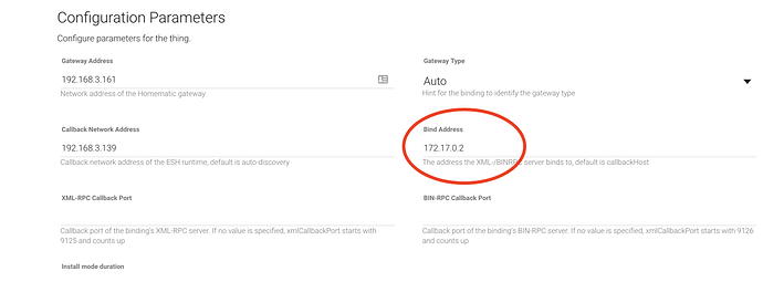

solution is in 2.5.0. Homematic has an addition parameter “Bind Address”
setting there 0.0.0.0 is the solution for homematic. Bridge goes online now

reseted things changed in
openhab starts attaching to .0.0.0.0 and now is reachable over the home network 192.168.2.252 and over the reverse proxy.
UPnP works too
I had the same problem with the release version of OH2.4 running in docker on a Synology Diskstation with two physical network interfaces.
I installed the test binding from here and set the binding address to 0.0.0.0.
Now my homematic works as expected.
