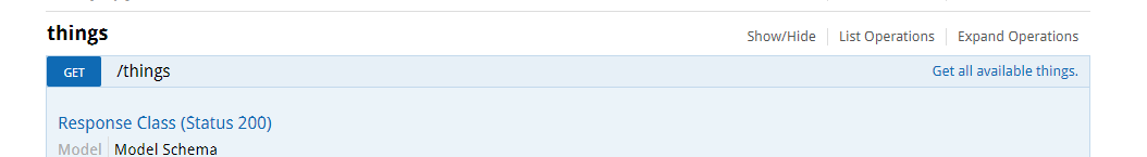

The easiest way from the browser is to install the REST Documentation under User Interfaces. That gives a pretty self explanatory web interface to the API.
This doesnāt seem to me to be the best option to be using in backend coding. Seems a little arse about face as the api must query the internal packages anyhow.
OK, you can query the REST API using https and cURL. It is a standard JSON based API. It looks like to get a list of all things, it is http://[ip address]:8080/api/things or curl -X GET --header "Accept: application/json" "http://[ip address:8080/rest/things"
I got that information from the REST Documentation.
