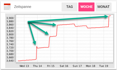

my disk space (SD card) grows after each snapshot upgrade.
see grafics:
I’m assuming, that here surely temporary files put on, which one could delete after the installation again?
Since I run daily backup, I would like to keep the image as small as possible.
Does anyone know how to clean up the disk space again?

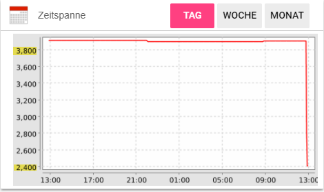

wow :open_mouth:
after
sudo apt-get clean
from 3900MB to 2400MB
THX a lot
Thank you too! I was hoping you would show us a new graph with the gained space. :smile:
