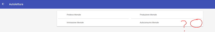

  1. I defined and updated the numeric value one Item by creating the corresponding point in the Model page of mainUI. As you can see the value is 73 in these case
2)I linked the Label element on the Sitemap configuration page to the corrispective item previously defined
  1. nothing on the sitemap…
In OH2.5 I think the solution was to add [%s] on the label on the .item file. now i’m not able to undestard
Maybe is the problem linked to do not have “linked channel” on step 1???
As you can image this is not a phisical device and no binding channes associated with it.
Thanks to help us to understand the changes.
The [ ] part is “state presentation”.
In OH3 you can edit this in Item stateDescription at Pattern box
Just use %s without the [ ] here.
Oh yeah thank you,
it is the solution definitelly.
Not intuitive at all.
Thank you!!!
