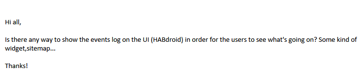

[SOLVED] Display log files in UI
try this (change your folder structure and ip)
Script (shows the last 1000 events sorted by last event in first position)
script openhablogs.sh:
#!/bin/bash
tac /opt/oh18/logs/events.log | head -n 1000 > /opt/oh18/webapps/weblogs/events.log
tac /opt/oh18/logs/openhab.log | head -n 1000 > /opt/oh18/webapps/weblogs/openhab.log
date +“%d.%m.%Y %T”
item:
String st_copyLogs {exec=“<[/opt/oh18/configurations/scripts/openhablogs.sh:60000:REGEX((.*?))]”}
sitemap:
Text label=“LogFiles” {
Text item=st_copyLogs label=“openhab.log [%s]” icon=“settings” {
Webview url=“xxxxx:8080/weblogs/openhab.log” height=20
Text item=st_copyLogs label=“events.log [%s]” icon=“settings” {
Webview url=“xxxxx:8080/weblogs/events.log” height=20
Thank You
I tried your solution @Tab_Daham
Bash script works fine. But how do you call the bash script? Is it triggered from openhab or by cron job or whatever?
from wiki: refresh in millisec.
> in: exec="<[<commandLine to execute>:<refreshintervalinmilliseconds>:(<transformationrule>)]"
should update every minute
Yeah, ok.
I was kind of blind.
And my problem was a permission issue.
Now everythinks works fine.
Thanks.
