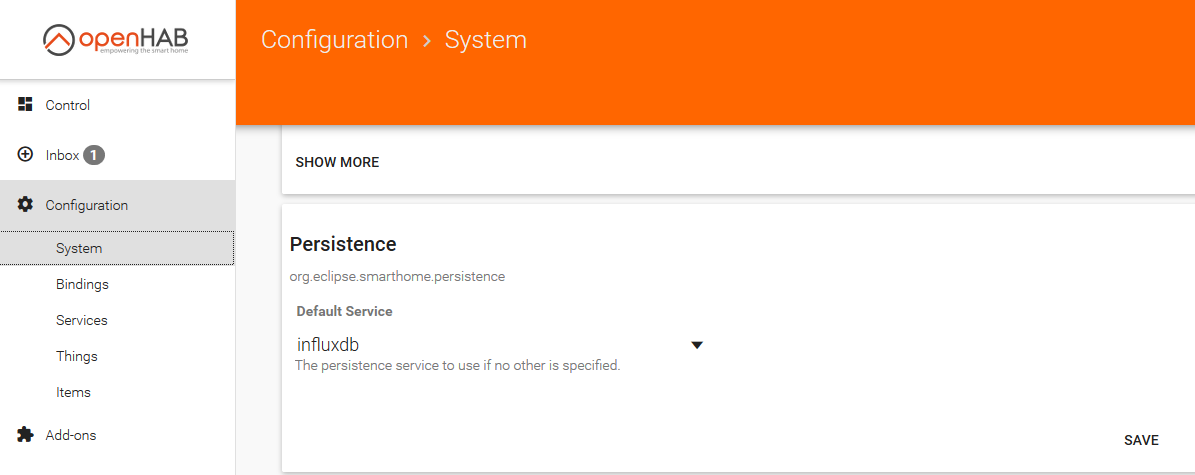

I seem to recall something about having a default strategy defined in xxx.persist, even if you don’t use it?
Did you specify in paperUI the service you will use by default?

now I have added the “default strategy” and now it works with MySQL!
