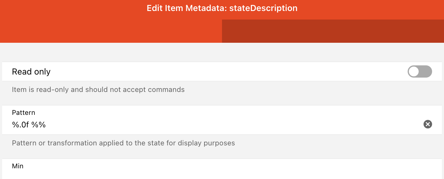

Also, I’ve tried what you suggested, which actually makes total sense but I am just being very noob here. I’ve tried different combinations and I am not being able to make it work. Am I placing it in the right place here?
humidity
I don’t find any other place to set the “state” other than on the JSONPATH.
That’s the Link. That’s not the Item.
Go to the Item page. There will be an “add metadata” link you can click and choose “State Description” from the list.
Put %.0f %% in the Pattern field.
Make sure to undo anything you’ve done on the link. That will probably break something.
