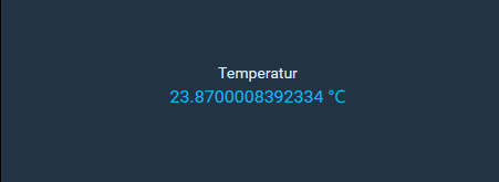

I have a dummy widget where i connected a temperature Item. The dummy widget shows me like: 10.302848392 °C but i want 10.3 °C. I know i can check serverside format but then it shows nothing. I want use the Format field to Round the Value but i dont know and i dont find anything to use this field.
I tested “%.1f” but nothing is happen.

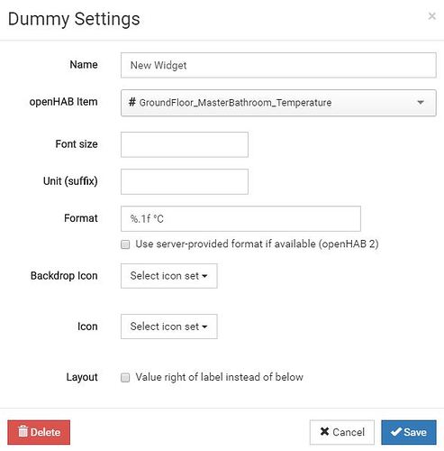

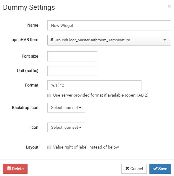

i tested it and it works with
%.1f °C

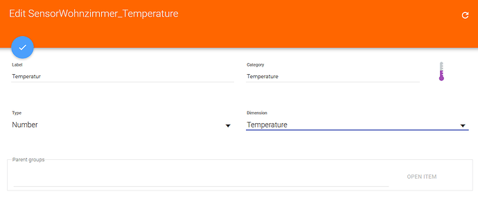

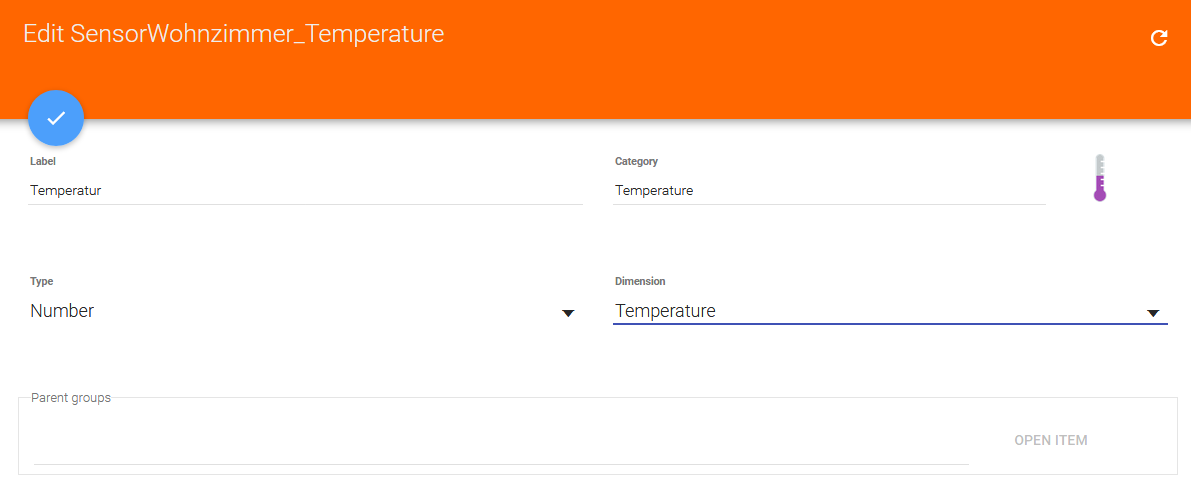

i have some pics, i cant find the item file on my raspbian.
Remove the temperature dimension in the item screen. And use “%.1f °C” in the widget format
Wuuhuuu nice ..it works thx man
