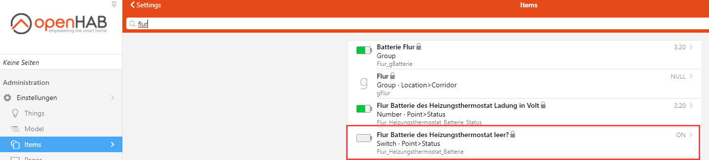

Hi Colleagues,
i updated finally to OH3 and played with the Semantic model a bit the last days.
Since i everything configured via files so far i try to do this for semantic as well.
I used this guide for it [OH3] Semantic Model setup via tags in configuration Items files
I ran into an issue, when test to display a dynamic battery icon per Items | openHAB
See my files:
groups.items
//INDOOR
Group gIndoor 			"Wohnung" 							["Indoor"]
Group gFlur 				"Flur"										(gIndoor) 		["Corridor"]
	Group gFlurHeizung  	"Heizung im Flur"							(gFlur)			["HVAC"]
	Group gFlurHeizungBatterie (gFlur) ["Battery"]
flur.items
//### Wandthermostat-Heizung #################
Number 			Flur_Heizungsthermostat_Signalstaerke 		"Flur Heizungsthermostat Signalstaerke" 								<qualityofservice> 		(gFlurHeizung) 	["Status"]						{channel="homematic:HM-TC-IT-WM-W-EU:ccu:MEQ1572637:0#SIGNAL_STRENGTH"}
Switch 			Flur_Heizungsthermostat_Batterie 			"Flur Batterie des Heizungsthermostat leer?" 							<batterie> 				(gFlurHeizungBatterie) 	["LowBattery","Status"] {channel="homematic:HM-TC-IT-WM-W-EU:ccu:MEQ1572637:0#LOWBAT"}
Number 			Flur_Heizungsthermostat_Batterie_Status 	"Flur Batterie des Heizungsthermostat Ladung in Volt [%.1f V]" 			<battery> 				(gFlurHeizungBatterie) 	["Status","Voltage"]	{channel="homematic:HM-TC-IT-WM-W-EU:ccu:MEQ1572637:2#BATTERY_STATE"}
Number 			Flur_Heizungsthermostat_Temperature	    	"Flur Heizungsthermostat Temperatur [%.1f °C]" 	        				<temperature> 			(gFlurHeizung)  ["Temperature","Measurement"]	{channel="homematic:HM-TC-IT-WM-W-EU:ccu:MEQ1572637:1#TEMPERATURE" }
Number 			Flur_Heizungsthermostat_Humidity  	        "Flur Heizungsthermostat Luftfeuchtigkeit [%.0f %%]" 	        		<humidity> 				(gFlurHeizung)  ["Humidity","Measurement"]		{channel="homematic:HM-TC-IT-WM-W-EU:ccu:MEQ1572637:1#HUMIDITY" }
Number 			Flur_Heizungsthermostat_IST_Temperatur 		"Flur Heizungsthermostat Temperatur IST [%.1f °C]" 						<temperature> 			(gFlurHeizung) 	["Temperature","Measurement"]	{channel="homematic:HM-TC-IT-WM-W-EU:ccu:MEQ1572637:2#ACTUAL_TEMPERATURE"}
Number 			Flur_Heizungsthermostat_SOLL_Temperatur 	"Flur Heizungsthermostat Temperatur SOLL [%.1f °C]" 					<temperature> 			(gFlurHeizung) 	["Temperature","Setpoint"]		{channel="homematic:HM-TC-IT-WM-W-EU:ccu:MEQ1572637:2#SET_TEMPERATURE"}
Number 			Flur_Heizungsthermostat_Luftfeuchtigkeit 	"Flur Heizungsthermostat Luftfeuchtigkeit Aktuell" 						<humidity> 				(gFlurHeizung) 	["Humidity","Measurement"]		{channel="homematic:HM-TC-IT-WM-W-EU:ccu:MEQ1572637:2#ACTUAL_HUMIDITY"}
String 			Flur_Heizungsthermostat_Modus 				"Flur Heizungsthermostat Modus[MAP(heizung1_de.map):%s]" 				<settings> 				(gFlurHeizung) 	["Status"] 						{channel="homematic:HM-TC-IT-WM-W-EU:ccu:MEQ1572637:2#CONTROL_MODE"}
Switch 			Flur_Heizungsthermostat_Comfort_Mode    	"Flur Heizungsthermostat Comfort mode"                  	  			<settings>     			(gFlurHeizung) 									{channel="homematic:HM-TC-IT-WM-W-EU:ccu:MEQ1572637:2#COMFORT_MODE" }
Switch 			Flur_Heizungsthermostat_Lowering_Mode    	"Flur Heizungsthermostat Lowering mode"                  	    		<settings>    			(gFlurHeizung) 									{channel="homematic:HM-TC-IT-WM-W-EU:ccu:MEQ1572637:2#LOWERING_MODE" }
Switch 			Flur_Heizungsthermostat_Boost_Mode    	    "Flur Heizungsthermostat Boost mode"                  	    			<settings>    			(gFlurHeizung) 									{channel="homematic:HM-TC-IT-WM-W-EU:ccu:MEQ1572637:2#BOOST_MODE" }
Switch 			Flur_Heizungsthermostat_Auto_Mode    	    "Flur Heizungsthermostat Auto mode"                  	        		<settings>    			(gFlurHeizung) 									{channel="homematic:HM-TC-IT-WM-W-EU:ccu:MEQ1572637:2#AUTO_MODE" }

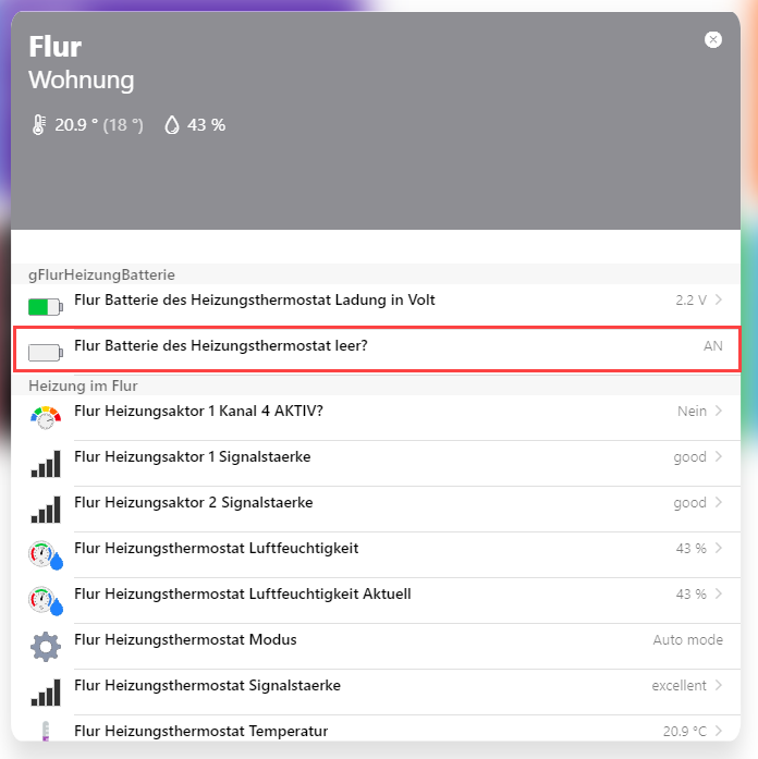

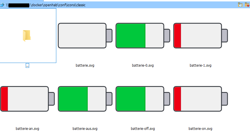

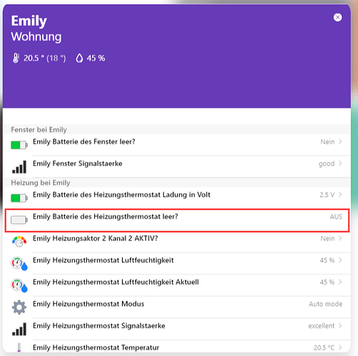

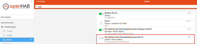

In the Screenshots attached you see it doesn’t matter if the value is ON or OFF, always the default icon is displayed. What i am missing here?
