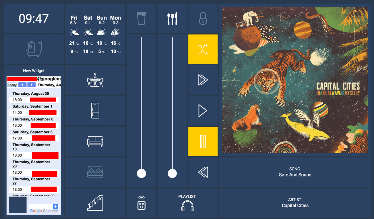

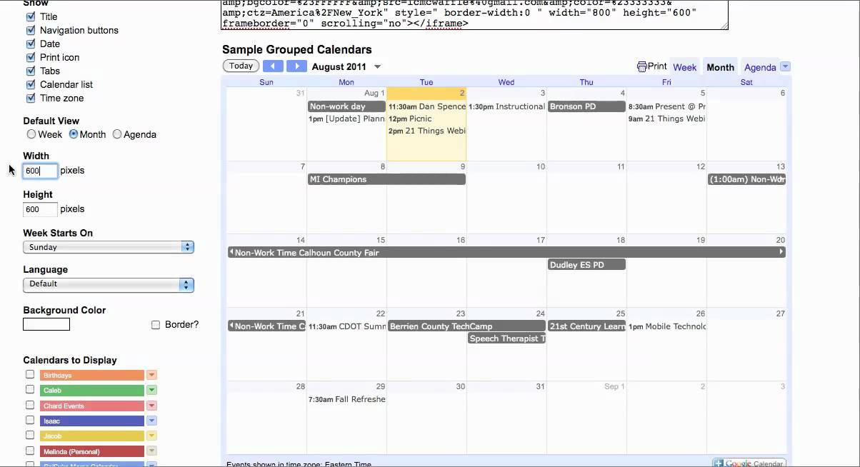

Yes what you are suggesting works, but in order to style the calendar to make it fit with the theme I have to run it through seperate software or service which requires it to be public as you can’t style an iframe with CSS. The other option is to copy the source files for the calendar and save locally to the /static/ folder and modify the stylesheet link, but again that requires the calendar to be public.

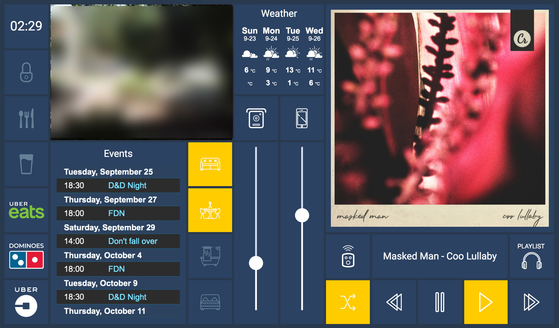

Yeh, thanks for the reply, like I said though I know how to do that, but the default Google calendar is just so 90’s looking. My habpanel looks so nice and then the calendar looks so crappy.

For anyone who is interested in a hacky fix for this, you can embed some filters to the style as below to modify to color to fit your theme as best you can:

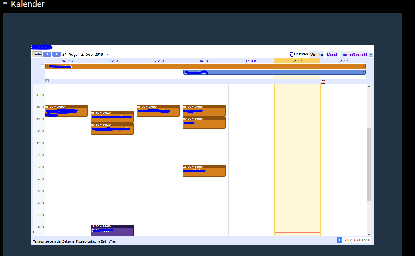

Nice how you got it mine does not work! it shows google logo on the top and much clutter from google
