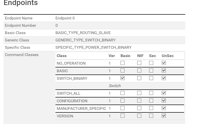

I’m still new to the configurations, but my ZW15R (bindings finds as ZW20R) is working and is the same as ZW20RM except the RM has the power meter, so I compared the database entries. As you can see in the first screenshot below, the classes do say SWITCH_BINARY, but the Endpoints still says SWITCH_MULTILEVEL. I get the SENSOR_MULTILEVEL, but should it really be a SWITCH_MULTILEVEL under Endpoints in the database (screenshot 2 below), or should it be the same as the ZW20R Endpoint and specify SWITCH_BINARY? I’m assuming SWITCH_MULTILEVEL signifies that it’s a varying current switch.

This doesn’t matter as this information is not used by the binding or database.
A multilevel switch is a dimmer - a binary switch is just a switch

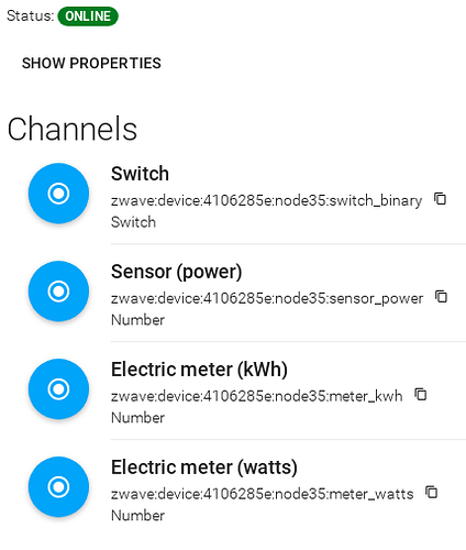

Thanks for the follow-up. It seems to now recognize it as a “Switch”, but the switch isn’t working; however, the meter is reporting accurately. When I hit the switch it doesn’t do anything. I’ve tried doing a heal, I’ve reinitialized it, I’ve excluded and included a few times, rebooted the server, and even gave it over night to start working as I’ve noticed sometimes it takes a bit for the switches to start working sometimes.
Looking at the database there are some differences that stand out between the ZW20RM and ZW20R other than the power meter, but I don’t really know what all parameters mean. The ZW20RM says it’s a Library Type LIB_CONTROLLER_BRIDGE and and the ZW20R is a LIB_SLAVE_ROUTING Library Type. Then under endpoints the ZW20RM still is listing “SWITCH_MULTILEVEL” with checkboxes under Basic, NIF, UnSec where as the ZW20R lists it as a “SWITCH_BINARY” with Basic and UnSec checked. Not sure if that helps, but it’s the only thing I can see that is different. If you don’t see the issue, is there a way I can play with the settings/config to test to get it working?
