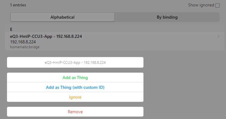

I’m receiving the (in the title) mentioned Error-Message while trying to remove the “Homematic CCU3-App”. Hide or Adding throws the same error message. Weird thing though: the CCU3 Bridge is already added and the HomeMatic Configuration works fine. Log is showing no Information (switched to trace level but did not see any hints).
Suddenly it showed up as per below:
ccu3_app
My setup is as follows: everything is running on a small ESXi-environement, including HomeMatic (Raspberrymatic)! I have a Pi Zero running as LAN Gateway to ensure radio-communication. The LAN Gateway popped up in Inbox (like the CCU3-VM as “CCU3-App”), but adding it to OH brings no added value, as it appears OFFLINE afterwards, so I removed it (which worked well and it did not show up again in Inbox).
I did not really take care of it as everything is working fine (and only kind of “flaw”). But I started now to set up a new virtual machine for OH3 in order to migrate my things and to get rid of some beginners mistakes I did when I started with OH2. However, the “CCU3-App” as shown above is shown in the fresh installation of OH3 with only the HomeMatic-Binding and I have the same issue: CCU3-Bridge successfully added and HomeMatic is working fine, but the “CCU3-App” is shown and I can’t delete/ hide/ add/ whatever.
Is this a known issue and how can I fix it? (This is now a matter of interest as I will have this issue still with OH3 then).

Is there any option to alter the UID of the device in order to make it “removable”? As shown in the screenshot, it states the bridge as “homematic:bridge:”, same in the DiscoveryResult.json-File. Even altering the DiscoverResult-File (and restarting the Openhab service) does not help, the UID is still shown with only 2 segments.
…Side note on it: the correct Bridge (same IP-address) is already added and is working properly. So only thing I want to achieve is to “clean up” the Inbox.
Thanks for further suggestions!

The CCU3 is already added as a bridge and working fine. But OH still shows me the “CCU3-App” in the Inbox (or additionally?).
My goal is just to get rid of the entry in the Inbox, it does not affect functionality.
