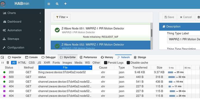

I’ve seen this for quite a while… there are a lot of 404 and 500 responses from just a single selection…
I used log:set OFF org.glassfish.jersey to hide them, but forgot to check to see if it had been resolved in another snapshot. I think this probably deserves an issue.

The 404s are possibly caused by requesting configuration for channels that don’t have any configuration (although I can’ see the URI in your image so I’m not 100% sure).
Are you saying though that these are consistent with the error that is reported in this thread, or is it a separate observation? If it is causing the error, can you grab the URI so I can see what’s up?
