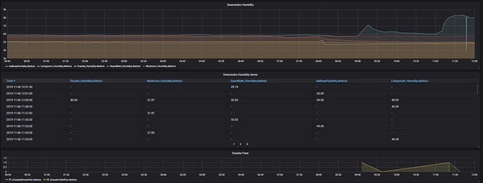

A snippet of my graphana data for today. (FYI, the downards spike in humidity on the ensuite fan was me toggling the data between values to artifically trigger my rule)
Any ideas on directions to go from here?
