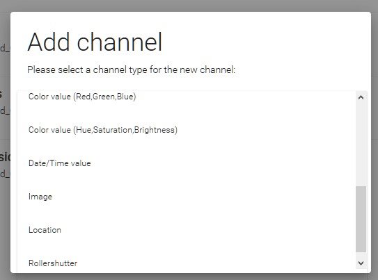

Problem is, I don’t have here any Dimmer channel type:
Yes, I keep saying this binding calls it “percent value”. I got that wrong. It calls it “Percentage value”.
You use the “Percentage value” channel with a Dimmer Item.
Dude, you are a star! :smiley:
Thank you SO much for all your help. It works like a charm and yes, all due to an incorrect translation because if that was translated as Dimmer or, at least, something like “Percent value (e.g. Dimmer)” it would be SOOO much easier.

I think it’s only this menu … once created, the channel says its a dimmer right?
That’s absolutely right. It says Dimmer. So even bigger confusion. So my suggestion to whoever has the power is to just change that for some future update.
