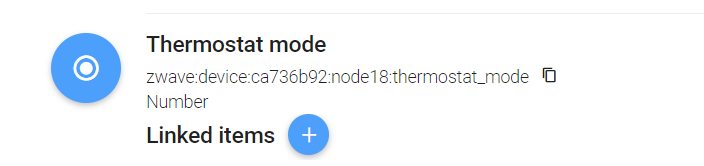

Can you do me a favor and check the thing for the “Thermostat mode” type ?
Mine is :
And I think this might be another hint since it’s of type “number”.
Yes of course:
Strange, mine is shown also as number …
I’m also on 2.5 stable.
