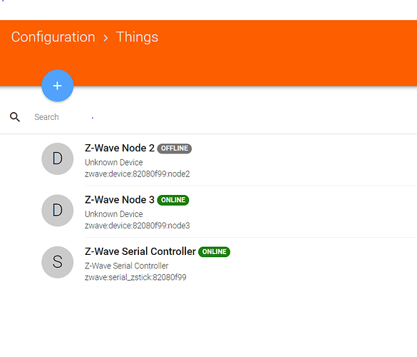

I connected the dimmer to the wall switch, tripple klicked the b-button and waited for things popping up in the Inbox .
After the initialisation I have got 3 things in my system but none was recognized as fibaro dimmer 2. As you can see below
Unbenannt
And the other unusual point is if I disconnect the dimmer 2 from the mains supply the z-wave node 3 is still online but the dimmer 2 is the only device in my setup until now.
can anybody help me with my problem?
Cheers Philipp

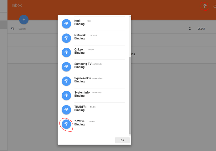

Nothing will show up in the Inbox until you press the circled buttons as indicated. (Topmost right first.)
This has to be done while the Z-Wave item is in inclusion mode.
In fact, you might need to do that first, then triple press the B button: (before OH inclusion scan terminates)

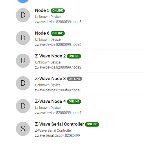

this is how i did it:
Attempt1
  • openhab2 ->inbox-> tripple klick b button → scan-> zwave
Attempt 2
  • openhab2 ->inbox–> scan-> zwave → tripple klick b button
now I have a lot of things in my system but nothing showed up as fibaro dimmer 2
Unbenannt
and I wonder what device they are
cheers Philipp
