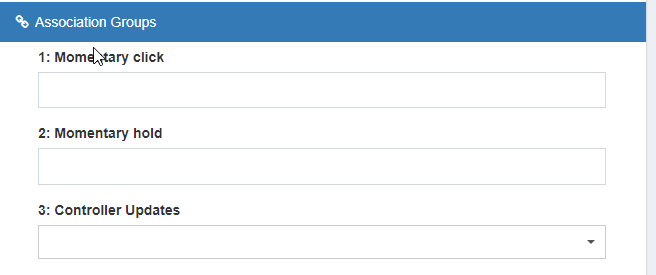

Also make sure you have the associations set correctly: Controller Updates
to Controller

what do you mean in your last line, this is my association configuratoin

I’ve configured the Association and its working !!
Not sure why I didn’t read about it until now
Thanks!
