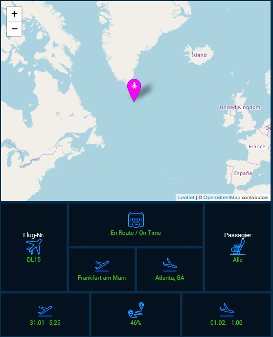

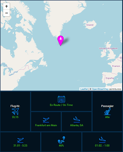

I am almost done.
However, I did not find a link to retrieve the aircraft type pictures.
After the next iteration and check, I will post the stuff here.
Here it comes.
Please let me know if you have questions or better suggestions for improvments.
What it does:
Whenever one of my calendar entries changes and an entry is detected with “Flug” (=flight), the information is extracted and used for a cross check with flightaware. The nearest flight is used for further processing.
Because the flight number is not unique and will re-occurr every day, I cross check this with the departure time in my calendar.
Then I constantly monitor the actual time vs. the departure time and track the flight using flightaware during the flight.
The location will be used for a map display.

And my Habpanel View
