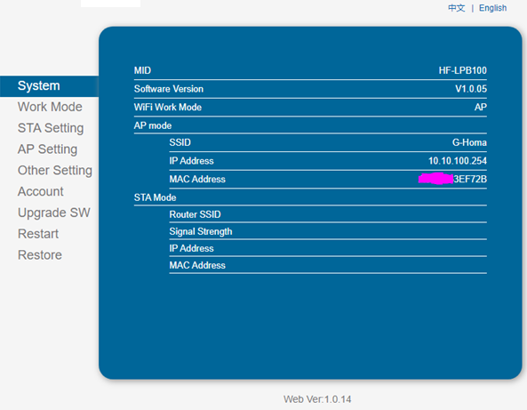

  10. open a browser to address http://10.10.100.254 (user: admin, pw: admin)

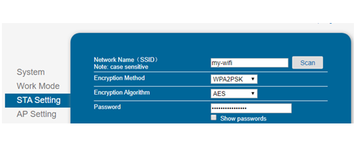

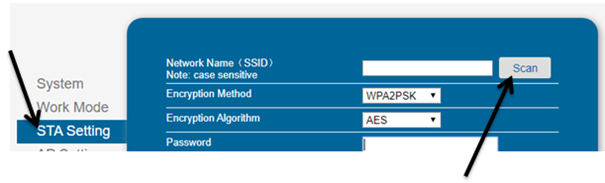

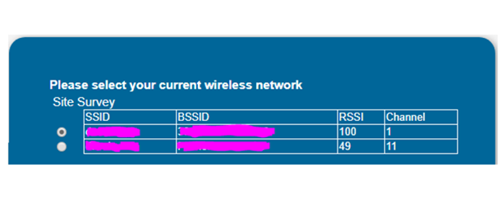

    a. go to “STA Setting”, scan and choose your local wifi

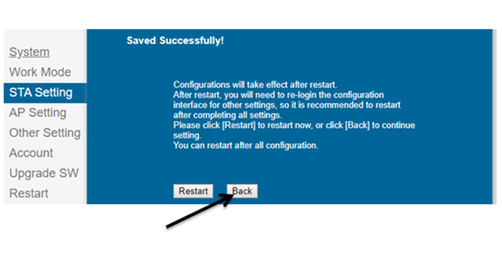

    b. important: always press ‘Save’ after you made changes, but do NOT restart your wifi-socket! Press: “Back

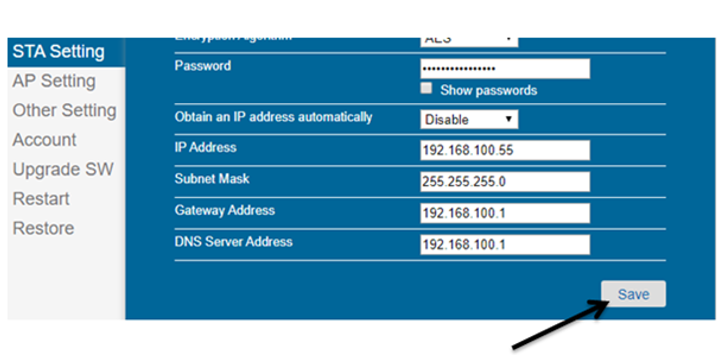

    c. fill in your SSID password and (optional) Disable ‘Obtain an IP address automatically’)
    d. (optional) fill in a manual IP-Address, Subnetmask, Gateway, DNS Server

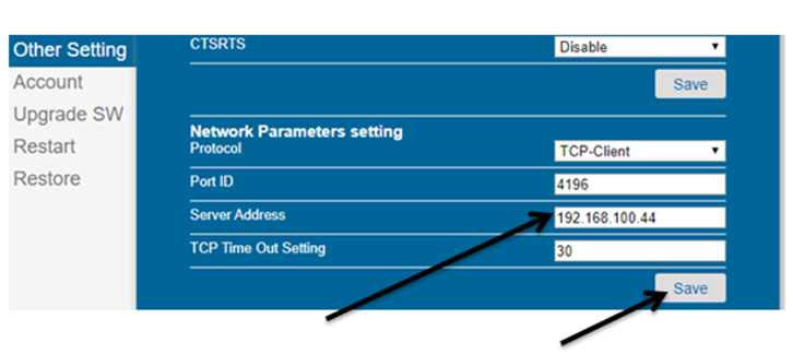

    e. go to “Other Setting’: fill in ‘Server Address’: this is IP Address where you started the express_example.js (in step 5 above).

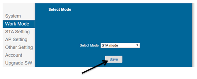

    f. go to “Work Mode” and choose “STA mode”, press “save” and NOW restart your socket.!

  2. open a webbrowser with address: http://IP-Address:3000/list where IP-Address is IP of your local machine in step 5.
  3. now you will see something like that: [{“id”:“3ef72b”,“state”:“off”}], where “id” is the short-MAC of your ghoma wifi socket.

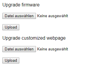

With an older firmware you would see the following (after login):
(Sorry, it’s in german!)
If no website is available, you could try the following:
Inside the above mentioned download folder, inside the zip file, there is a file called: lpb_web_ew_V1.0.14.bin (1.0.14 is the same version as you can see in my system settings in 2nd screenshot above)
This is the “web interface”. Maybe you can upload it again onto your socket.
