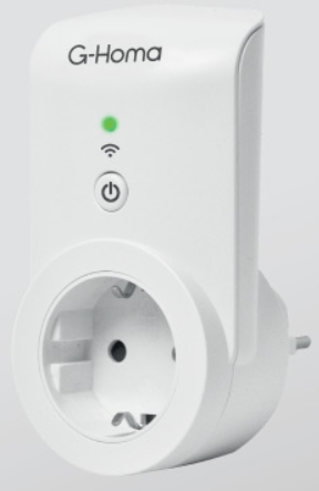

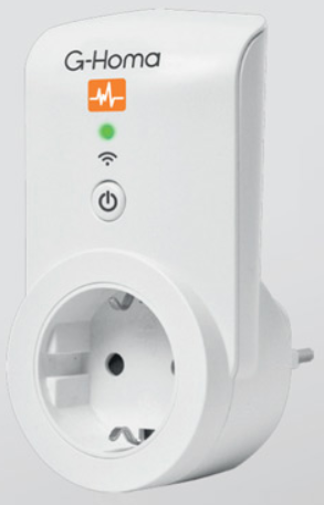

[SOLVED] G-Homa Wifi Smart Socket “EMW302WF“ and “EMW302WFO” with OpenHAB2
Manufacturers: REV Ritter, GAO, EverFlourish
http://www.rev.de/DE_produkt_13876.ahtml
http://www.rev.de/DE_produkt_13999.ahtml
https://www.rev.de/DE_produkt_15058.ahtml
http://www.g-homa.com/index.php/en/products
Technical data: 230 V~, 16 A, max. 3500 W
(Available in Germany at OBI, Saturn, Globus Baumarkt, Toom Baumarkt, ELV and so on…)
Prices for EMW302WF: OBI (9,99 EURO) (at my local OBI !), Saturn (15 EURO), Globus: (24,95 EURO), ELV (29,00 EURO)
Price for EMW302WFO: OBI (14,99 EURO) (at my local OBI !)
I got it running with openhab2! I have 9 of EMW302WF and 2 of EMW302WFO
Not tested: EMW302WF-CTL See here: https://www.rev.de/DE_produkt_15058.ahtml
Also could run, but has to be tested!!
They have mounted the following wifi module: HF-LPB100 or HF-LPC100 like Orvibo S20 or Silvercrest SWS-A1.
I tested Orvibo-Binding, but it was not running! Here is a different way how to get them running:
INSTRUCTIONS: (running nodejs 8.9.4 and java script version “ghoma 1.0.6”)
A new manual for later versions you can find here!
If you don’t want to use cloud based G-Homa App and need an integration into OpenHAB2, you can use your own “control server” written in nodejs.
See here: GitHub - rodney42/node-ghoma: Control server for g-homa wifi plugs
or here: https://www.npmjs.com/package/ghoma
