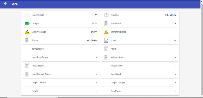

Hoping for some help here i have upgraded my ups today but i have now got items that no longer have a value

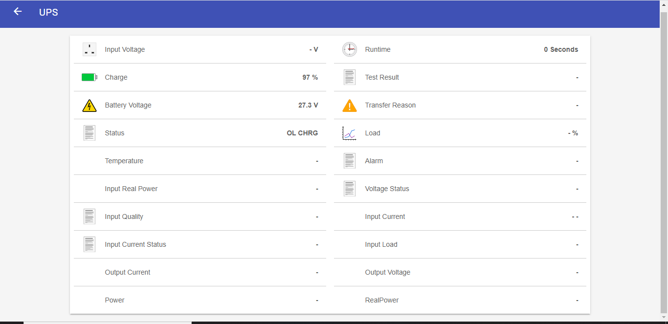

my new ups is a Apc smc1500i-2uc its connected to my synology ds1819+ it’s working fine and I have the ups server enabled on the synology and connected too the NUT Binding (OH) but I notice i have items that used to report a value that no longer do BX700UI apc ups
I have been looking for a command too run on my synology too see what information the ups is reporting too the NAS but can’t find it anywhere now I have used it before on openhab does anyone know this command or have an explication too why its not reporting as much information as the older cheaper unit?
my older unit had values for Input Voltage, Runtime , Load
I would obviously like too have things like temperature reported but i’m pretty unhappy that some of the major items are no longer working
any tips appreciated

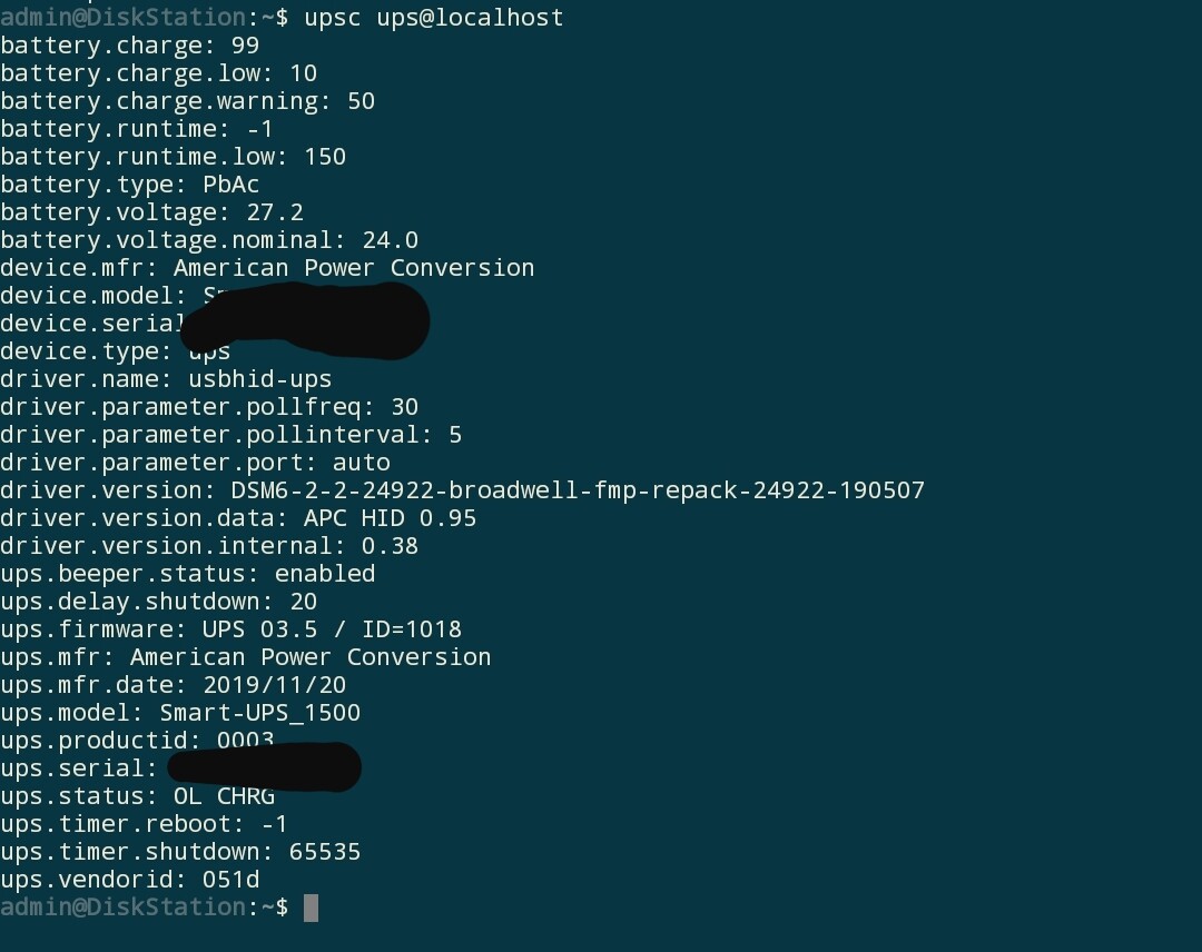

Not all UPS devices report the same information. Run the upsc command from a machine configured with a NUT client or on your synology. What you see as the result is the sum total of all the information that is available. It might be a short list. I would not be surprised if most of that information is simply not available.
As an example, my UPS doesn’t report any of that missing information either.
Hi again @rlkoshak thanks for the reply I’m just having a few problems at the moment I have ran the command you sent and agree this information will not be available anymore sadly
My ups is connected too my synology with USB the ups reports itself as fully charged but looking at the Synology DSM it reports as being 99% charged and using the upsc ups@localhost command (thanks for that) reveils that it thinks the ups is at 99% OLCHARG and with openhab being connected too the synology as a slave its receiving the wrong information too its pretty annoying and im not sure what I can do too fix it I think it’s a problem between the UPS and NUT on the synology or just NUT in general

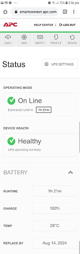

^ From APC SmartConnect
^running upsc ups@localhost on ssh too Synology DSM

OH is only ever going to be able to report what NUT is reporting. Since NUT is reporting 99%, that’s all that OH will ever report. Given that, your answer as to what, if anything, you can do about this discrepancy will be found on a NUT forum and not here.
But if I were to guess, I’d say it’s the UPS itself that is reporting the information wrong as all NUT does is query the device over the USB connection and report what the UPS itself told it to report.

The UPS has finally updated OH as 100%
there must be a compatibility issue between NUT and the UPS or something sadly i still don’t have a value for LOAD or RUNTIME

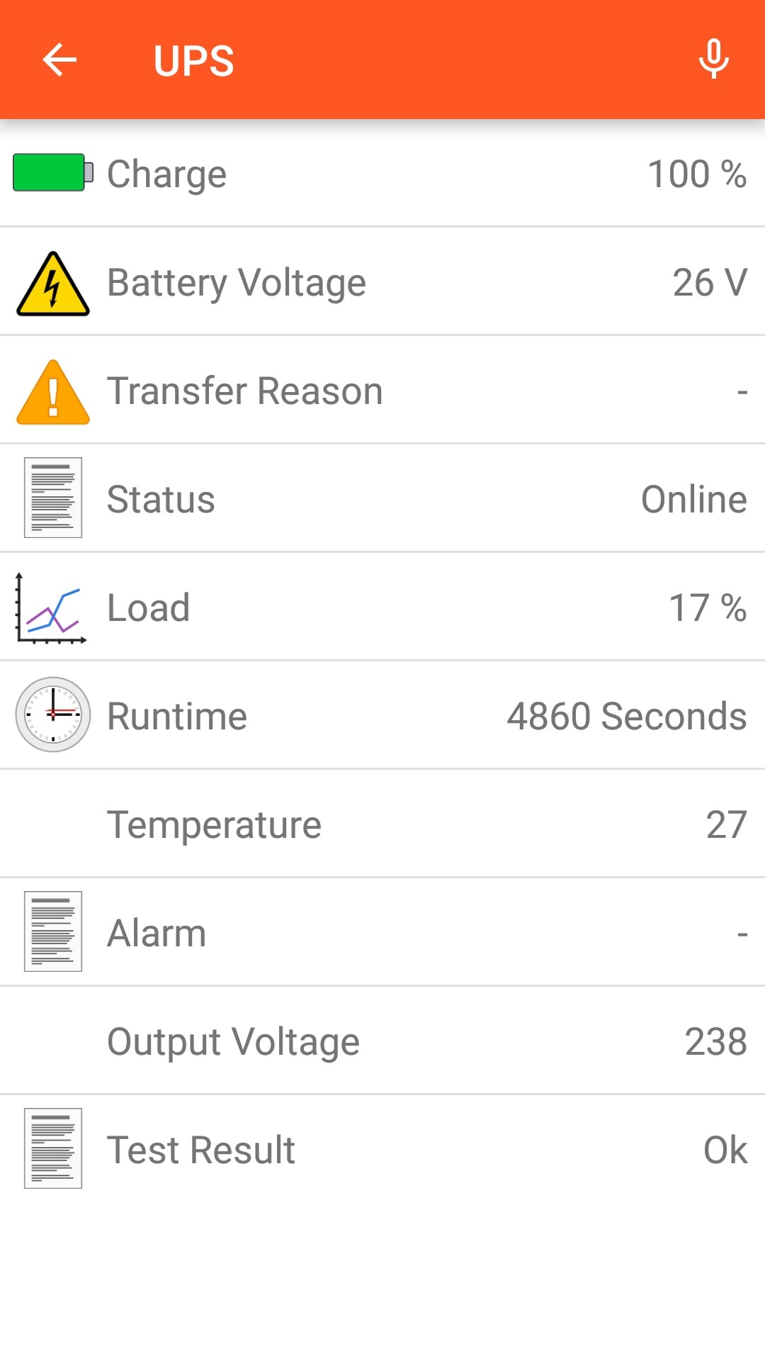

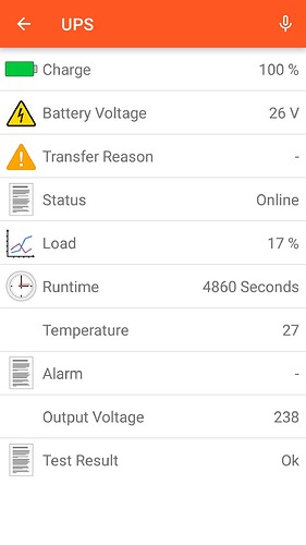

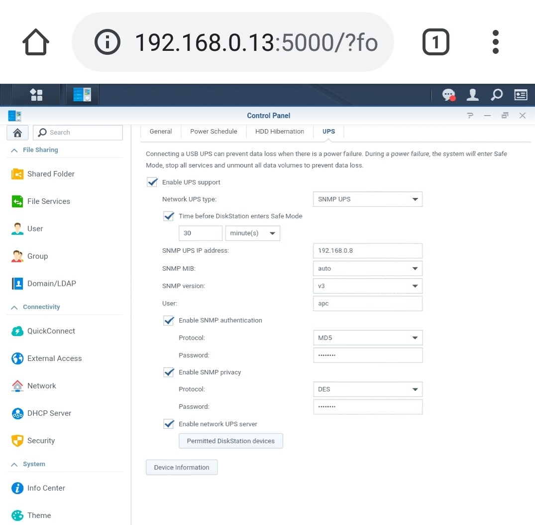

For anyone interested in pulling better information from there apc ups and Synology

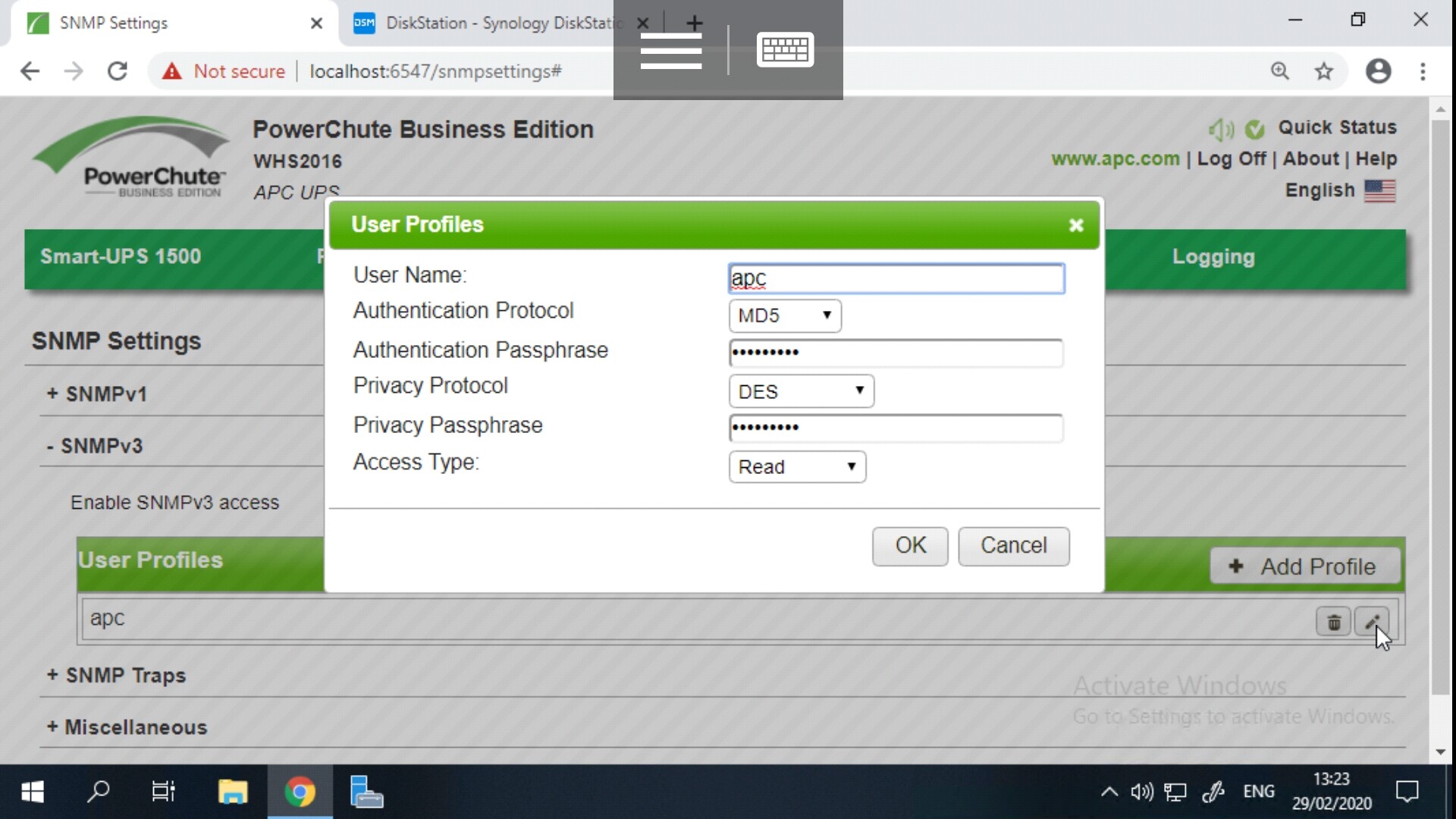

I had better results connecting the UPS via USB to the pc running Powerchute Buisness Edition
enabling snmp v3 on PCBE
Then add the UPS to the NAS under SNMP UPS using the details entered into PCBE & enable ups server on synology (NUT)
and give access too OPENHAB under permitted devices
and then use the NUT Binding too poll the information

Synology then connects too PCBE over SNMP
Synology has share this ups enabled this uses NUT
Openhab then connects too my synology using NUT

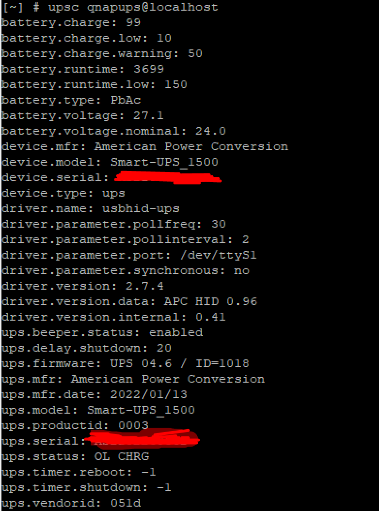

Actually the 3493 is opened in my qnap and I get:
Could not find the begin string pattern in the data while reading VAR ups

Change device from ups too qnapups
