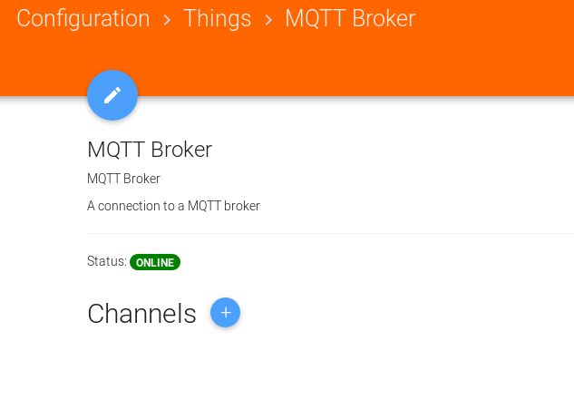

I’ve created a Thing that looks like this:
Although i’m not quite sure what I’m meant to do with the channels.

Version 2 works with things, you have created the broker thing ( which acts as the bridge between the broker and openHAB and does NOT need any channels). Now you need to create things for each of your devices.

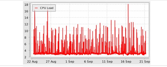

You probably are referring to InfluxDB- Grafana. InfluxDB is are strong database and Grafana is a good graphic-tool to show graphs from that database.
For a start I would not use such migthy tools, espacially on a single Raspi3. I’m using rrd4j as a database with the build-in tools to shows graphs and my Raspi3 is running good with it (>100 days without reboot), see my sitemap graph below.
or from HABPanel:

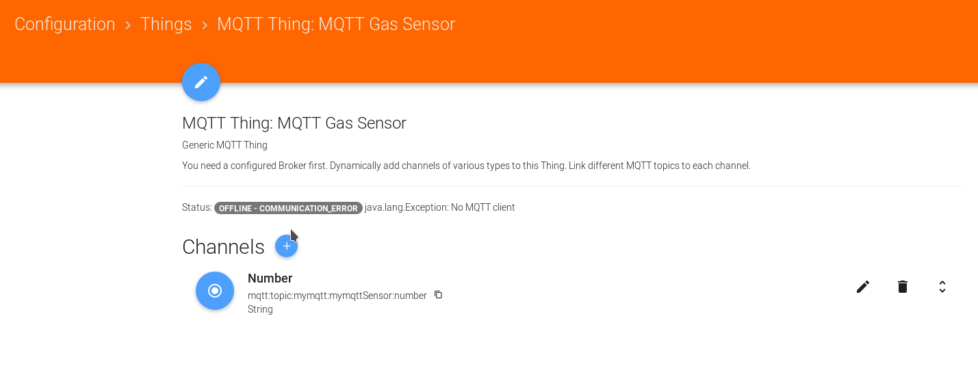

For some annoying reason most likely to do with the above config files, the PaperUI status of the sensor under things is OFFLINE. Any thoughts as to where I may be going wrong?
Let me guess, you are on the 2.4 stable release version and you did not restart openHAB or at least the mqtt bundle after creating/changing to mqtt things files ( it might only be the broker thing file).
This is a known bug in this version and it is solved in the actual milestone and snapshot versions.
I am on this version as well, as long as there is no need to change the file(s) it is running fine!

The broker came back online under Things in the PaperUI while the sensors things disappeared :frowning:
What did the log say when openhab restarted?
2019-09-21 17:08:20.347 [WARN ] [el.core.internal.ModelRepositoryImpl] - Configuration model 'gas_sensor.things' has errors, therefore ignoring it: [8,13]: mismatched input ']' expecting RULE_ID

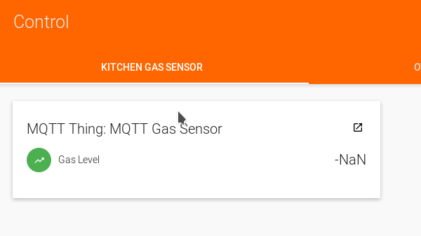

Ok, its online now. It was the comma that i forgot to delete after I removed the CommandTopic. Now the Thing is online and I’ve linked it to the item. Its showing on the panel although no number/data is showing. I must be posting incorrectly with MQTTfx so it’s probably not picking up.

Interestingly, everytime I sudo services openhab2 restart, it all links nicely and shows in the PaperUI panel. Its just the number that is not being picked up when I publish
sensor/state 6
on the MQTTfx app. Not sure I know how to debug this …
