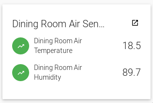

What is interesting is that PAPER UI shows as if there were two lines:
Even more suspicious is that PAPER UI is also showing the humidity of the ESP8266 sensor logging to MQTT but I have not added a line to my items file for humidity:

Only the first is recorded in m items file. This must be the origin of my problems with my SQLite persistence not working for Diningroom_Temperature. Any clues as to why I’m getting Temperature and Humidity showing up in PAPER UI even though there is no line in my items file? How can I get rid of them?
SOLVED: My suspicion that there is a parallel life for items was ture (although I’m not sure how its handled).
It turns out that under Configuration ->Things in PAPER UI you have to unlink the item in the relative channel and delete the item from there. So, I deleted the Temperature item and re-linked the things temperature channel to Diningroom_Temperature. All of a sudden, there is line added to my items table in SQLite database and Diningroom_Temperature is finally being persisted. Phew! It took me hours to work this out and the solution was so simple …
