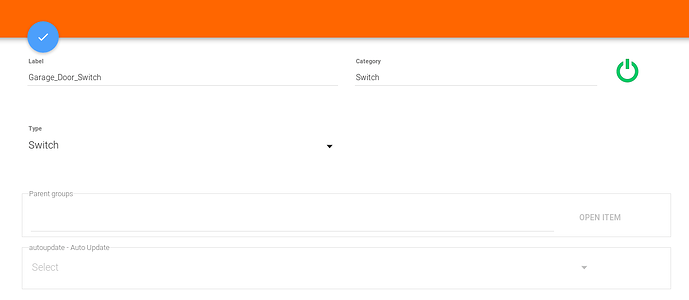

I created a new Switch Item in PaperUI’s Items menu that I will use for the garage door switch. I understand that I need to create a Rule to update that switch’s state based on the barrier state’s numerical value. However, when I go to create a rule to do just that, even though the Barrier State item is a numerical type the only options I get are boolean (on/off, open/close, up/down) not numerical. Any advice?

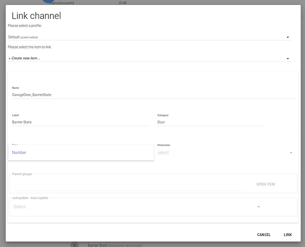

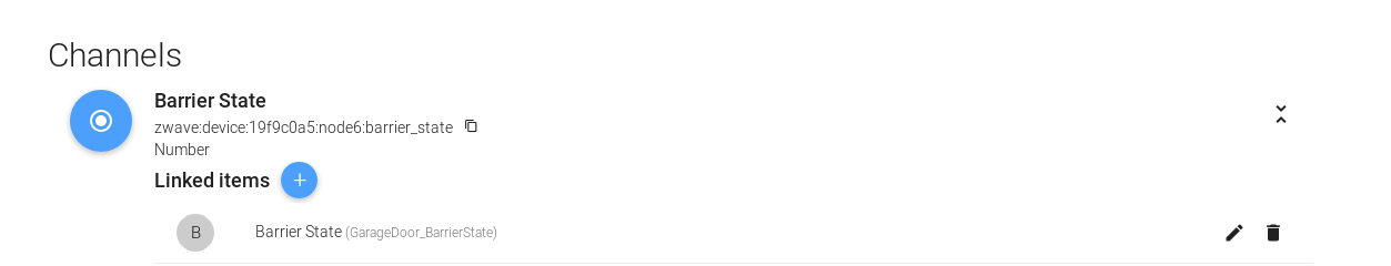

I’ve got the Number Item and it is linked to the the Barrier State channel on the Thing. And I have create a switch Item that I intend to use to control the door. How I “use rules to update the Switch when the Number item changes” is one issue. Also from the links that @sihui provided it appears that I need to somehow map these numerical values (0, 255, etc) to positional values (open, closed, etc.) and that I don’t know how to do either.
