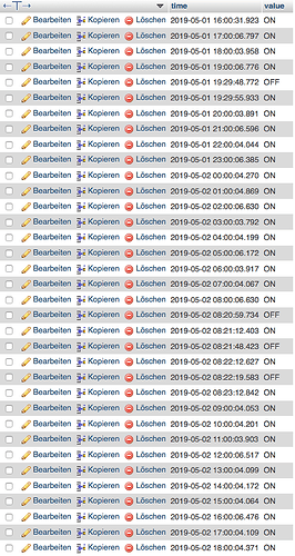

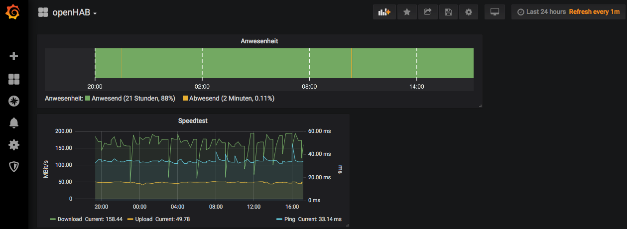

I started yesterday at around 4 o’clock pm. But in my charts there is a timezone missing (from 11am until 1pm).
I had similar when using the ‘Discrete’ panel, to show Presence. The query contains a timestamp to retrieve data from, but as you’re recording data hourly (my presence could have been many many hours), the previous entry was not shown.
Therefore, I found I needed to amend the query to UNION the most recent data entry from before the start time, like this:

Here’s what it looks like if I remove the UNION from the first series:
FLOOR(UNIX_TIMESTAMP(time)) as time_sec,
CASE WHEN value = 'ON' THEN 1 ELSE 0 END as value,
'Confused' as metric
FROM openhab.item0001
WHERE $__timeFilter(time)
SELECT
time AS "time",
CASE WHEN value = 'ON' THEN 1 ELSE 0 END as 'Anwesenheit'
FROM presencesebastian_474
WHERE
$__timeFilter(time)
ORDER BY time asc
But the problem also exists with the other charts.
Your query is not retrieving enough data to fill in the beginning of the graph.
