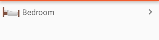

However I want to define a group structure which reflects all my rooms on the Sitemap.
So I define a group “Bedroom” in the items file and add it to the Sitemap.
I also add the “BedroomSwitch” to the group “Bedroom” like
Group Bedroom "Bedroom" <bedroom>
Group:Switch:AND(ON,OFF) BedroomSwitch "Bedroom Switch" <switch> (Bedroom)
Switch Bedroom1_Toggle (BedroomSwitch) { channel="hue:0100:1:bedroom_bulb_1:brightness" }
Switch Bedroom2_Toggle (BedroomSwitch) { channel="hue:0100:1:bedroom_bulb_2:brightness" }
Switch Bedroom3_Toggle (BedroomSwitch) { channel="hue:0100:1:bedroom_bulb_3:brightness" }
and just add the top layer group “Bedroom” to the Sitemap
sitemap home label="Wolfgang-SmartHouse"
Frame
Group item=Bedroom label="Bedroom" icon="bedroom"
I get my top laywer “Bedroom” which has an arrow to the next layer on which Iwant to see the Bedroom Switch.
and on the next layer I see the switch but not with a switch button as in the example before
It has an arrow instead which brings me to a layewr with the 3 single switches
What do I need to change to have the “ON/OFF” symbol against the Bedroom Switch and not the arrow to the single switches’ layer?
