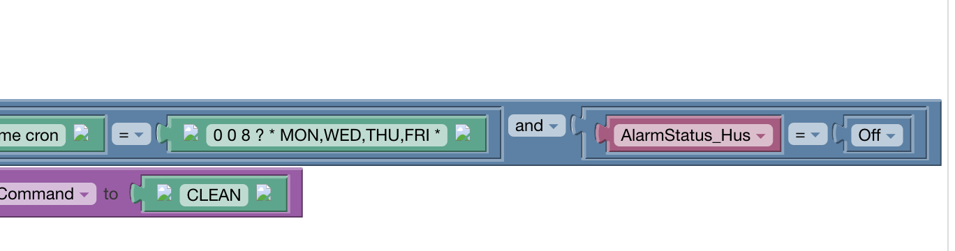

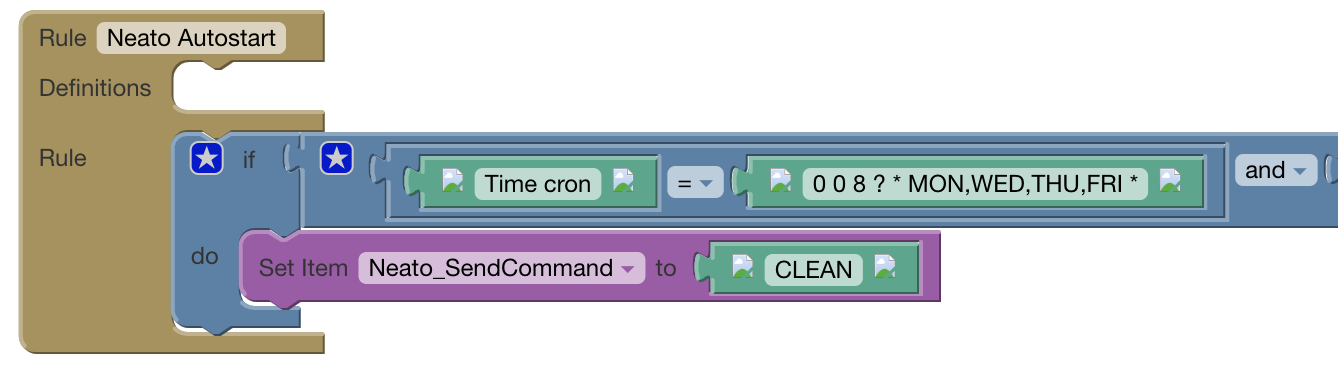

I have tried to make a rule manually in a .rule file. But I could not work this way, I do not get any log in. So I have tried to use the rule designer in HabMIN. But I can not work this either, so I get the following message in log:
2018-11-23 06:35:42.185 [WARN ] [el.core.internal.ModelRepositoryImpl] - Configuration model ‘(1)_neato_autostart.rules’ has errors, therefore ignoring it: [13,1]: no viable alternative at input ‘then’
It’s a simple rule that sends a CLEAN command to my Neato vacuum cleaner. Monday, Wednesday,Thursday, Friday at 8.00, but only if the alarm in the house is armed. (Then, do not start if we go on a day off and sleep long).
Attached is a screenshot from HabMIN and error message from log.
I can’t understand, why this has to be that difficult, and what i am doing wrong? :frowning:
I am not sure, since I don’t use HABmin for rules…
You should restructure your rule and follow this logic:
when time cron is …
if AlarmStatus is OFF
set item Neato to clean
Can you switch to </> Source view and post the source code?
