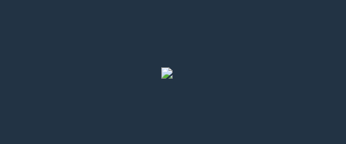

I’m not able to load my custom icons in habpanel.
I’ve copied the icons in /etc/openhab2/html/icons /etc/openhab2/icons/classic
but none seem to work. This is a beginner problem probably, but I just can’t seem to get it to work.
icon-widget:
hyphens are not allowed in dynamic icon filenames. It breaks the select-by-state mechanism, which uses a hyphen.
EDIT -to explain your surprise at the URL a bit, the UI does not fetch icon images directly but asks an “icon provider” service. That supplies the image according to state.

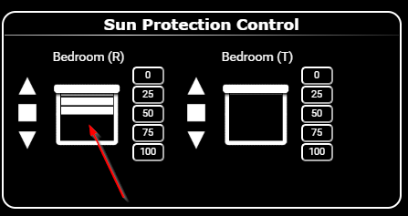

Icons are placed in the “icons” folder. Renamed as suggested by @rossko57.
Now the blinds are changing according to the state of the blind_control value!
