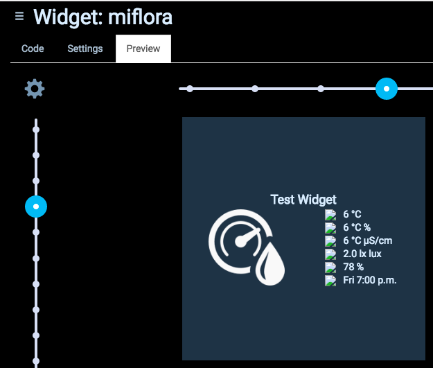

I Am creating a template which hosts a static image as well as some OH items.
The items are displaying correctly, but I cannot get the image url to load…

the browser tries to render:
[myOHaddress]/static/images/N/A
It appears that the {{itemValue(config.image)}} is not pulling the string I set within the config for the template and is returning N/A instead.
I’ve tried various combinations including putting the mediatype in as seen in other examples. I always just get N/A as the uri.

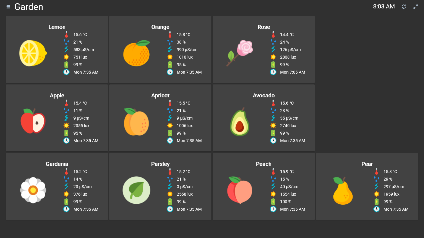

Here are the relevant files in case anyone wants them:
miflora.widget.json (3.8 KB)
I found that I needed to use rules to insert the strings for the widget title and image:

Once I had the right strings in the rules, I could use them to show the image by setting that item in config.
Hope this is useful to others. Mark

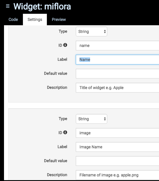

@marklavercombe - you probably don’t want/need to use items and a rule in order to configure your widgets titles and icon filenames of your widgets. I imagine you can replace the config items in your widget with two text configs (one for title, one for filename of the image) which would allow you to get rid of the rules as reduce the amount of items in your system.
Thanks @danielwalters86.
I tried that but kept getting N/A instead of the string for the image file and it wouldn’t show.
Can you show me how that might work because I’d love to simplify things!
Cheers :slight_smile:
@marklavercombe
  1. I made these changes to the config
  1. Then made small tweaks to the code:
21
  1. It will then pull the value you set in the string config items through to your code so that it displays the title and image icon
Hope that helps!
