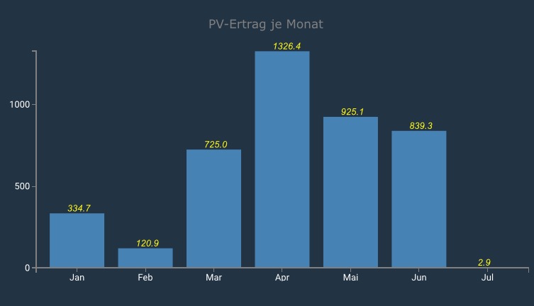

I solved the above problem. The solution was to put a special “header” at the beginning of the PHP-File:
<?php
header('Access-Control-Allow-Origin: *');
Now I got a first small success generating a simple D3.js bar chart within a template widget out of my persistence database of OH which is PostgreSQL. I will write a small tutorial in a separate thread as soon as I created a good example. … it will take some days.
