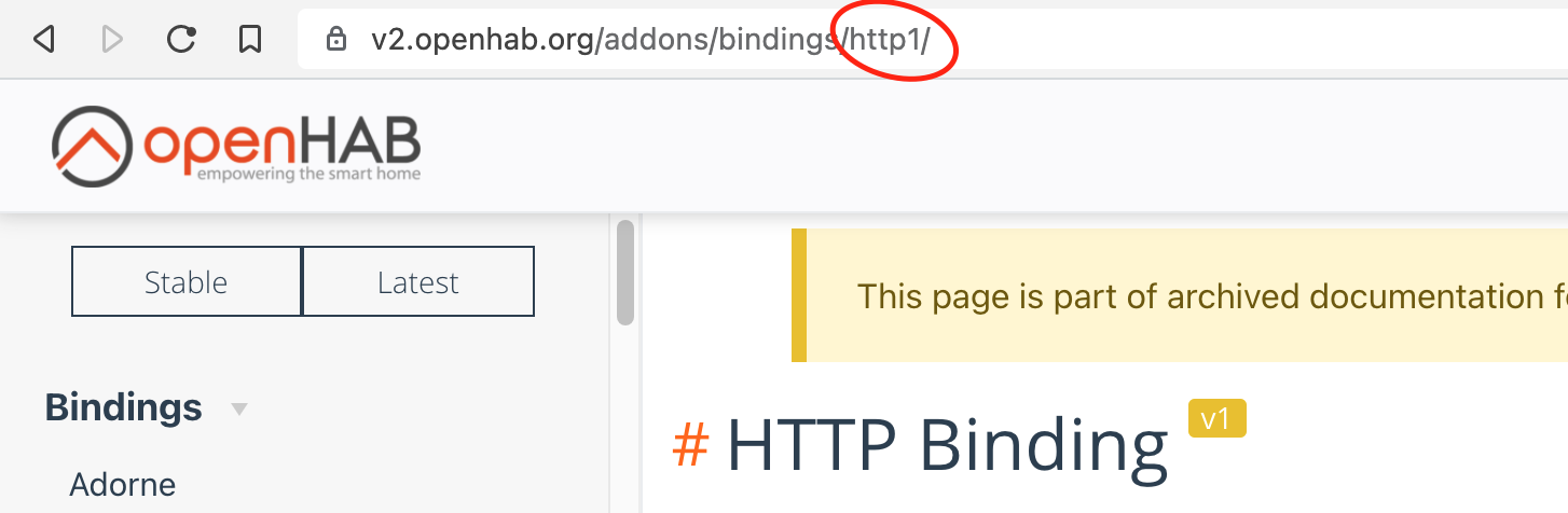

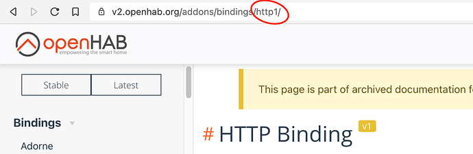

Hakan’s approach is what I use but just to provide another avenue for those who may not have PaperUI installed, you can use the URL of the README doc for the binding. For example the URL for the README for Air Quality is Air Quality - Bindings | openHAB and the URL for the HTTP binding is HTTP - Bindings | openHAB.
If you look at the last part of the URL, that will be what you need to put into addons.cfg: airquality, http1

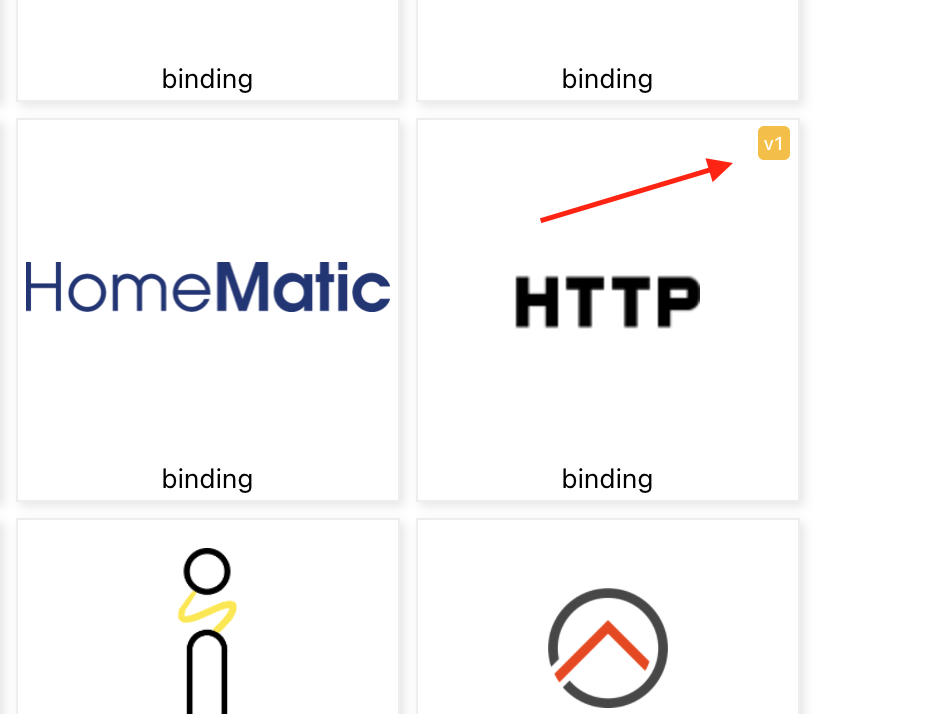

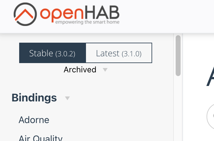

Just to elaborate a bit… that two year old post was referring to OH 2.4 (I think). OH 3 wasn’t yet a thing. OH 3 supports no OH 1.x bindings. So of course, if you choose an OH 3 version of the docs:
the pages for OH 1.x versions of bindings will not exist. They are not supported. They are no longer maintained.
However, the archived 2.5 version of the docs does still list the 1.x bindings.
And you can still look at the last part of the URL to find the value to be put into addons.cfg.
However, I strongly recommend against starting with a new 1.x binding no matter what version of OH you are running. These add-ons are no longer supported so any bugs that exist in them will never be fixed. New features will never be added. And most users on this forum will not support them when you run into trouble.
