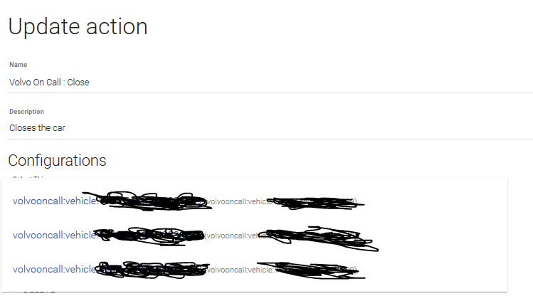

When using the code on the doc site I get:
Pulpos available Actions: org.openhab.binding.volvooncall.internal.action.VolvoOnCallActions@xxxx
In the NRE I get three same Things when trying to map the commands.
Even after deleting the actual thing.
So I assume that there are some old Thing configs!?
