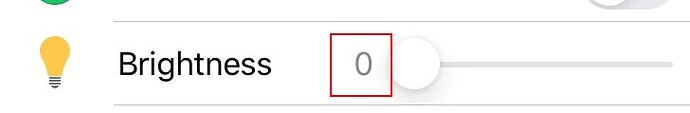

I am trying to hide the value of a slider item on a sitemap but am having no luck. The item is working as expected however I would just like to hide the value. My sitemap item is listed below;
Slider item=bedroom_lights_brightness label="Brightness" icon="staticlight"
This is how the item appears in my sitemap and would like to hide the number;
I am running version 2.4.0 Release Build.
Any help would be greatly appreciated !
Edit
I have tried adding empty brackets to the label but that did not work.

Thank you all for the input, I have tried all of the suggestions mentioned here with no success.
Perhaps this is an issue with the 2.4.0 release build.
