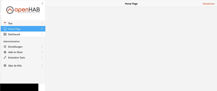

  1. I have troubles setting up my home page as I have created it successfully as a page in Settings => Pages but when publishing it to the sidebar it is empty.

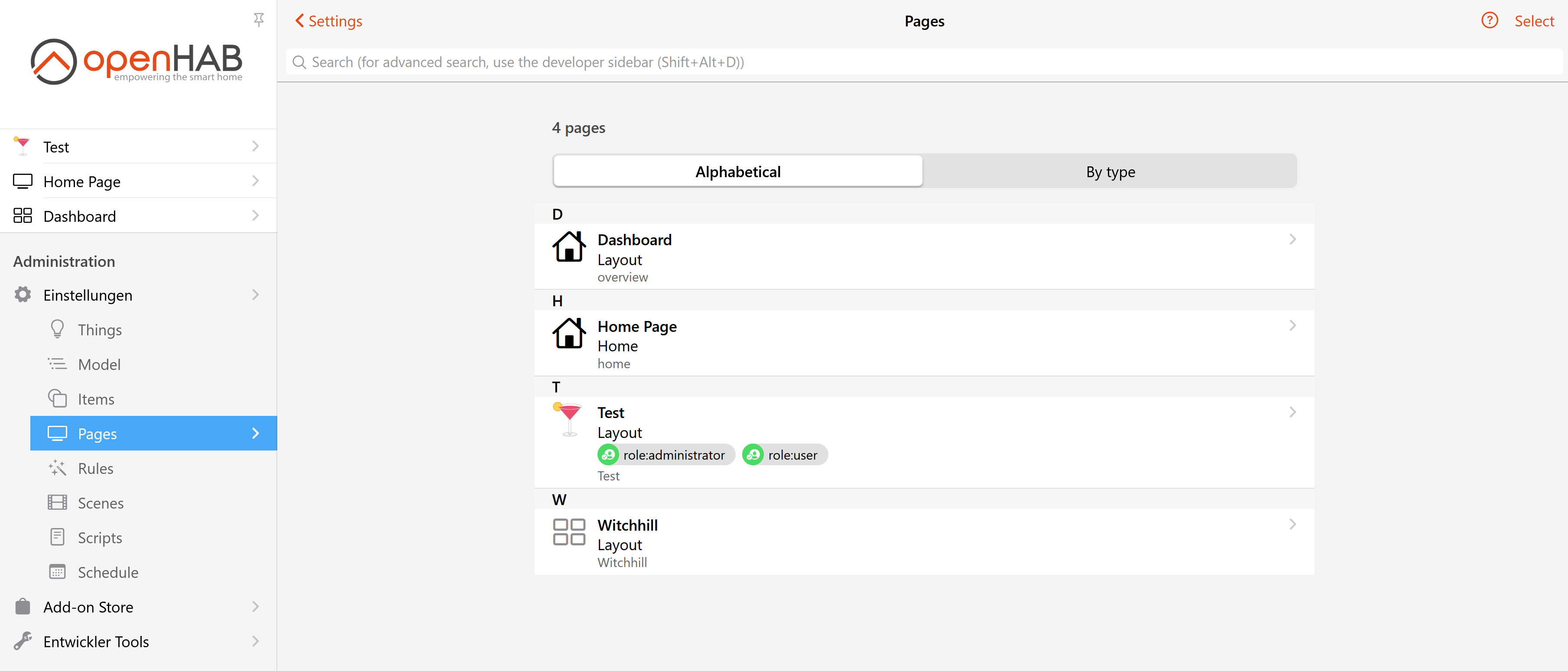

First screenshot: Showing my Settings => Pages view where I would like to delete the last two pages “Test” and “Witchhill”

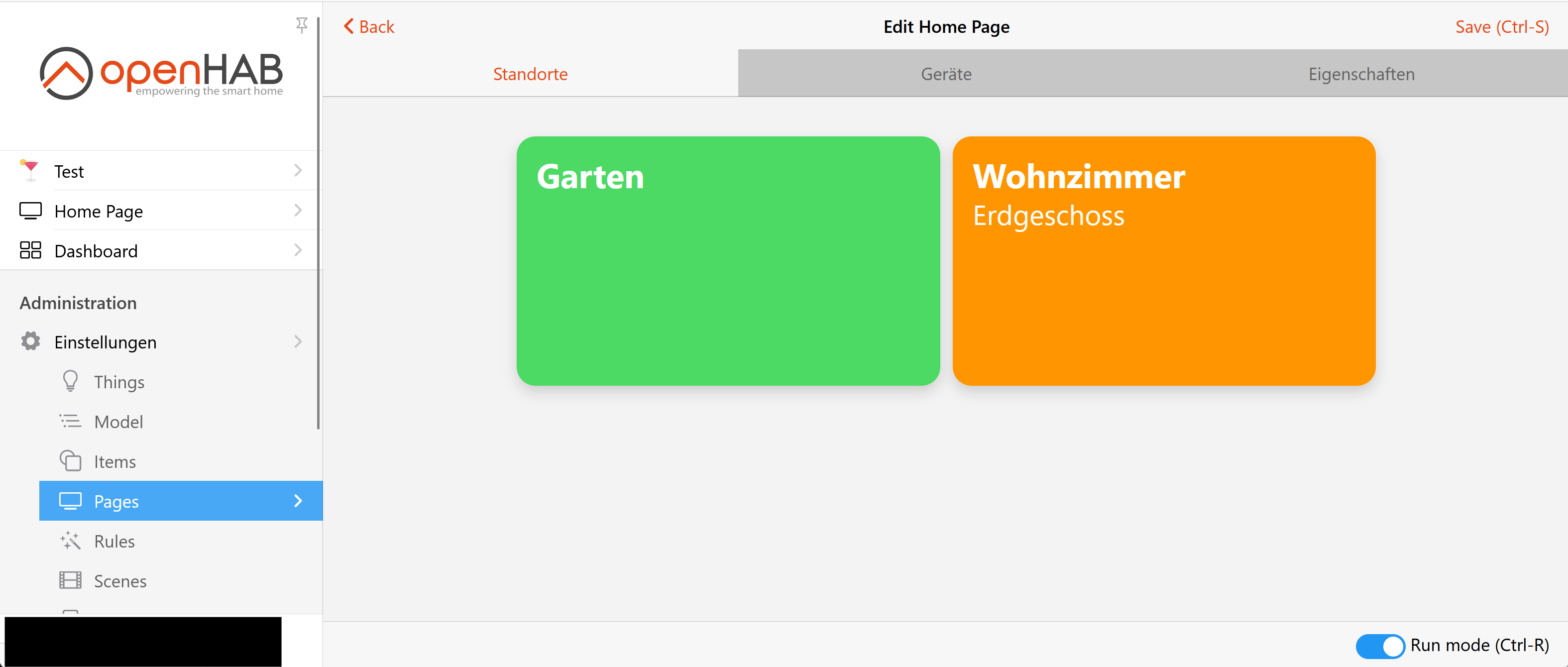

Second screenshot: Showing my Settings => Pages view for my “Home Page” in “Run mode” (see bottom right)
Third screenshot: Showing my “Home Page” called from the sidebar with no content

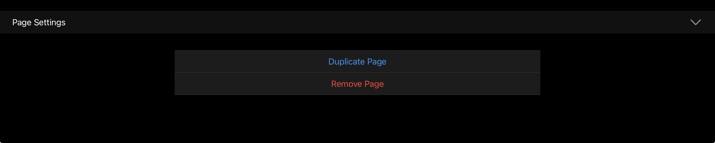

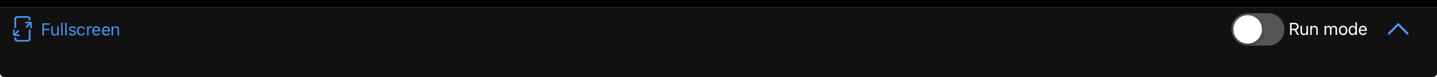

  1. Delete when in the page
If you open the page (to edit) and at the bottom of the screen there is a blue Arrow
(facing up)
Click that arrow and scroll to the bottom to delete the page - It should be displayed in Red

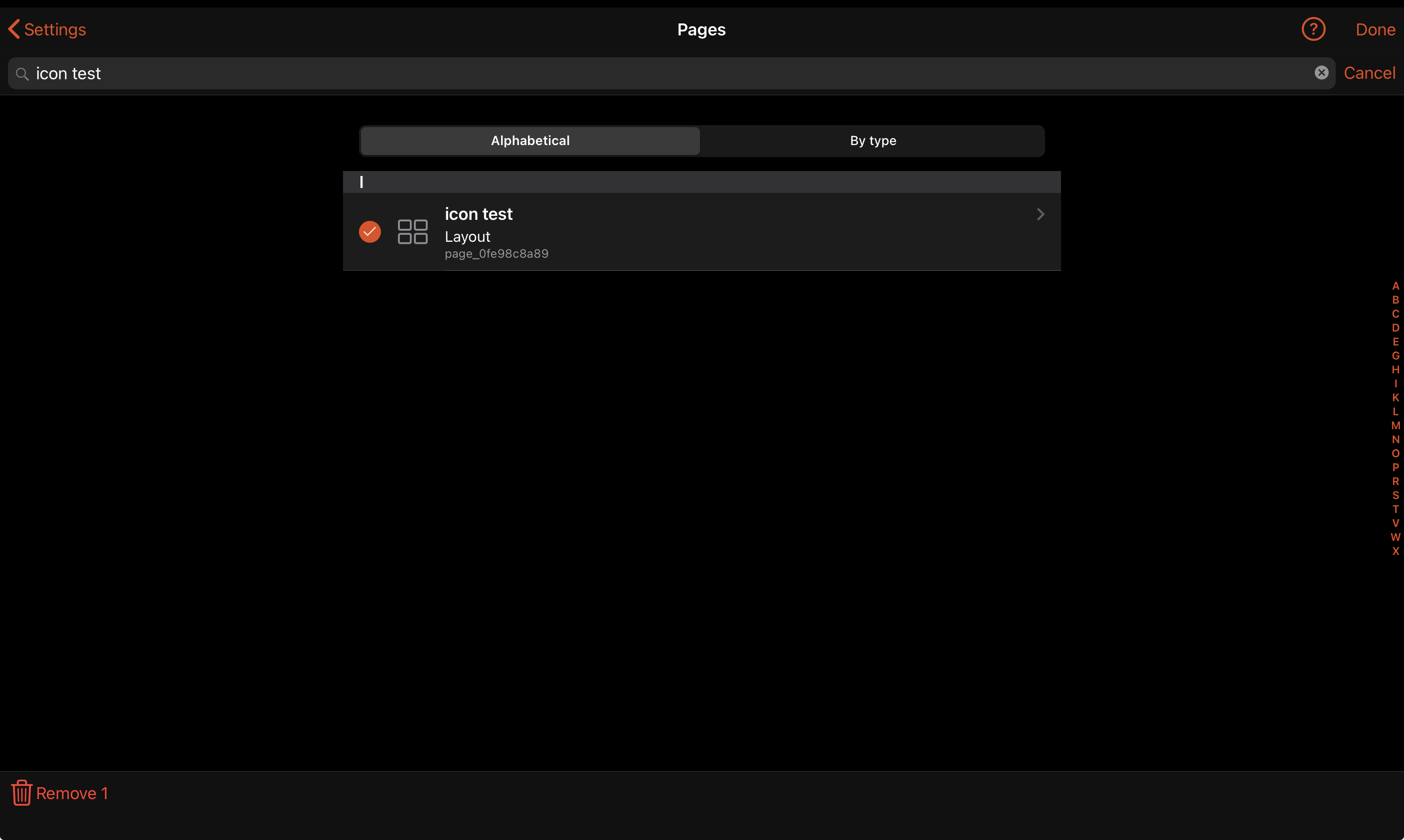

  1. Delete from Select
When you click the Select when listing the pages, the pages listed should change and have a “radio”: button next to each page that allows you to select a page and then select Deleted (in red) on the bottom, left corner.
If this does not happen the try a different browser.
Having said that I have realised you are on 5.1 M1 which while re-reading your post and that is a development branch so perhaps all of these issues are related to that and you are testing. If you wanted a production version then look towards 5.0.3
This worked! THANK YOU!
I tried Chrome, Brave (based on Chromium), MS Edge and Firefox they all show no radio buttons :frowning:

I’m no expert at this, but how did you manage to add the Home Page to the sidebar in the first place? I don’t think you’re supposed to, clicking on “openHAB” on top of the sidebar will take you to the combined “Overview” and “Home Page”. The “Home Page” isn’t actually a regular page (confusingly), instead it’s the “bottom menu” of the “Overview” page.
The only way I can fin to add the “Home Page” to the sidebar is to edit the YAML (in “Code” view), and if I do, it shows as a blank page for me as well. But, that’s not so strange, given that it’s not actually a “page” in a regular sense.

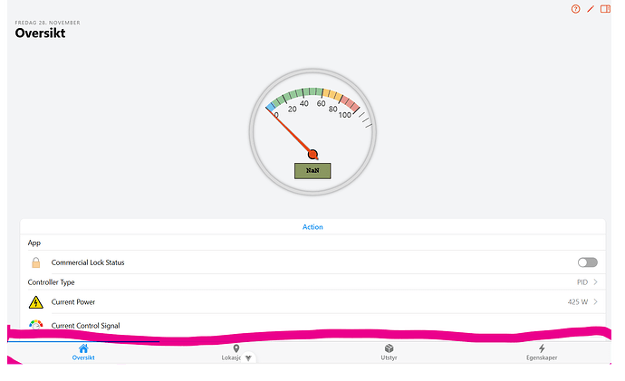

Personally, I think this is very confusing, but the “Home Page” and the “Overview” are actually “one page”. You can customize the “Overview” page as you want, the “Home Page” is actually just the menu on the bottom:
(Sorry for the terrible marking, but I did on using a laptop pointing stick :wink: )

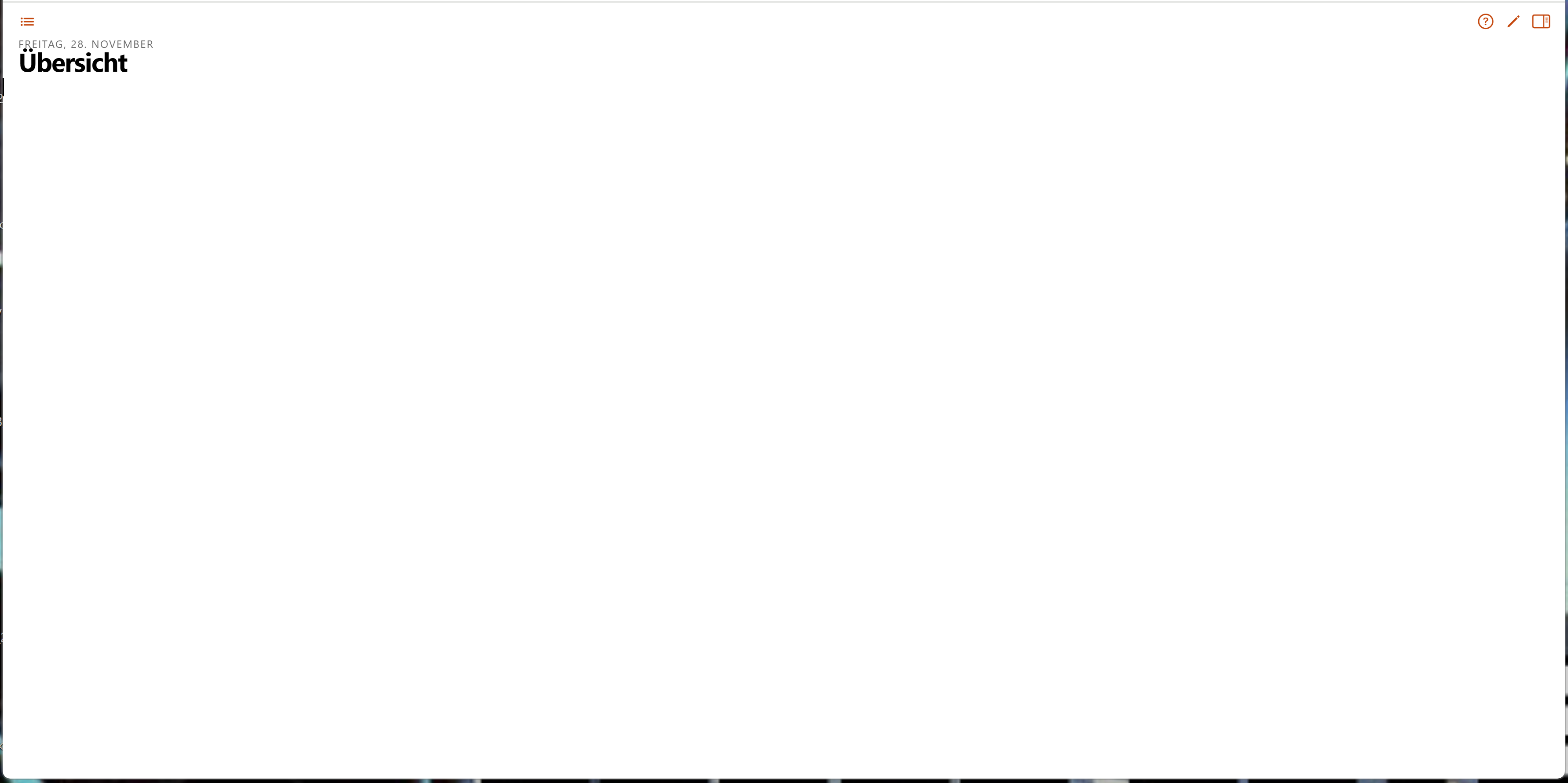

If I “hack” the “Overview” page in the “Code” view so that I can add it to the sidebar, it will show without the “Home Screen”, and that only means that the menu on the bottom is missing:

click overview then click edit home page then go to code and put this back.

then save and you will have all the tabs back
if you can not get there Then in your browser URL from the overview URL replace /overview with /settings/pages/home/add then click code and add what I posted above.
Thank YOU! The tabs are back !!!
