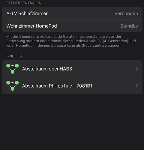

hm…
  • item configuration is good
  • pairing is fine
  • network connection is fine
    im getting out of ideas.
last try, please do following:
  • close home app
  • start logging with “log:set TRACE io.github.hapjava”
  • start home app
  • paste here the first 20-30 lines of the log.

do you have any items tag with homekit tag? what you see in home app?
if you have access to karaf console, what you get if you execute there
homekit list
Yes, I‘ve one WeMo Outlet tagged with HomeKit metadata. The list command in karaf returns nothing.
I believe this is the bridge itself not the „device“. You need to delete the bridge in Homekit, Clear the pairings via Karaf (and select a new pin in OH). Then you should be able again to add the homekit-bridge.
if karaf returns nothing then the item is not tagged correctly. the list in the karaf is the list home app receives.
check your tagging

I removed the tagging from the WeMo and followed the whole remove, clean-up and restart procedure described above again. I found that I left out one part of step 8 which is another restart of OH (setup HomeKit and restart OH). Which of both actions (or both?) did the trick I don’t know, but now I could add OH as Bridge (and not as device). It also displayed for a while the temperature of the Netatmo sensor in HomeKit, however I messed that up again by trying to add another temperature sensor (this time outside temp) to the game.
Is it necessary to do the whole procedure after every change in the metadata tagging? Just changing the metadata appears not to translate to what karaf reports with the list command.
Definetly no need for a restart after every change!
If you have a working „Thing/Item“ in Homekit just add one after the one. Most important is deleting the bridge in HK and waiting a bit. Clearing the pairings and then readding the bridge with one working item and continue.
there was a bug in 3.0 version of homekit binding that ignored metadata changes. basically, only change in non-metadata would trigger refresh of accessory.
bug was fixed in the recent snapshot releases.
an ugly workaround if you dont have the fixed version - after adding metadata change something on the non-metadata, e.g. name of the item. this would trigger the refresh.
no openhab, binding, repairing should be needed
