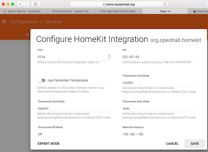

The weirdest thing I remarked now is that whatever I put in “Network Interface” is immediately changed to a kind of “fallback” IP address 192.168.1.100 !!!
My OH server’s IP address is: 192.168.1.233:8080 (local) or https://myopenhab.org:443 (external)
See screenshot below:
Thanks on beforehand for any tips which bring back HomeKit…
:cold_sweat:
Actually, I saw the same on @RiotMode 's screenshot:
