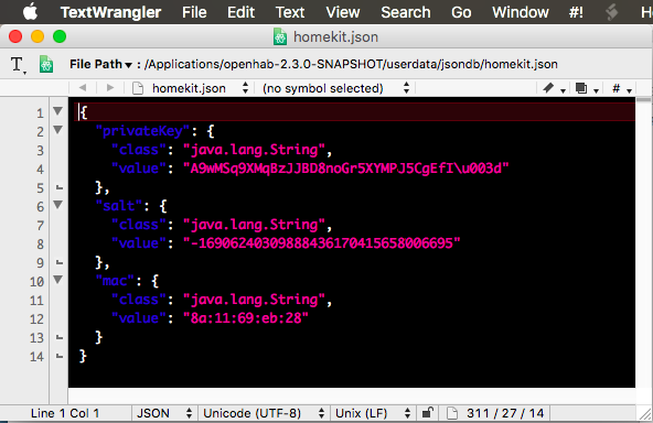

i deleted this file and started over and worked for me

This is maddening. I cannot make Homekit work on my Raspberry Pi. I’ve tried everything in here.
cleared Pairings, allowed unauthenticated, cleared out the homekit.json file, using a new code, i’ve tried reinstalling the whole openhabian image… nothing seems to work.
