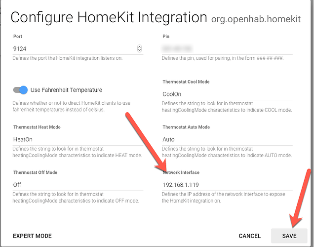

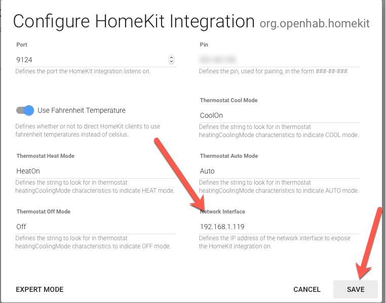

After many attempts, it worked by adding openhab IP into the Homekit Configuration panel (Paper UI).

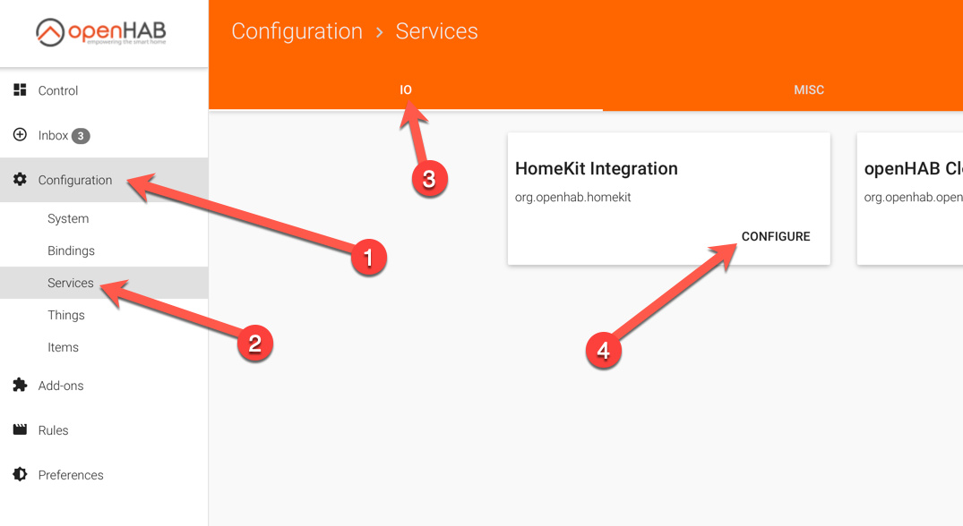

where did you enter the openhab IP in the homekit configuration panel? I don’t see any fields for it.
Hey Russell, check these screenshots for where to go if you are using PaperUI!
son of a gun, that worked!
Nice! Glad that got it for you!
