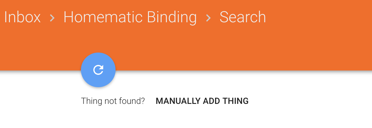

Now I wanted to add them to openhab via the homematic binding.
Problem is that the binding doesn’t find my homegear as a bridge, as I understood, this is how it should work?
